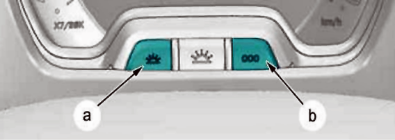

Also, the procedure to reset the maintenance is missing some steps as you have listed it.
To reset the maintenance interval, you need to do the following:
  • Switch off the ignition then turn the key to the steering lock position "S"
  • Press and hold the service indicator zero reset button (button 'b' in the diagram above)
  • Switch on the ignition: The service spanner and a countdown from 10 to 0 are displayed on the instrument panel screen
  • Maintain the pressure on the service indicator zero reset button until the countdown 0 appears and the service spanner disappears
  • Switch off the ignition or release the zero reset button
