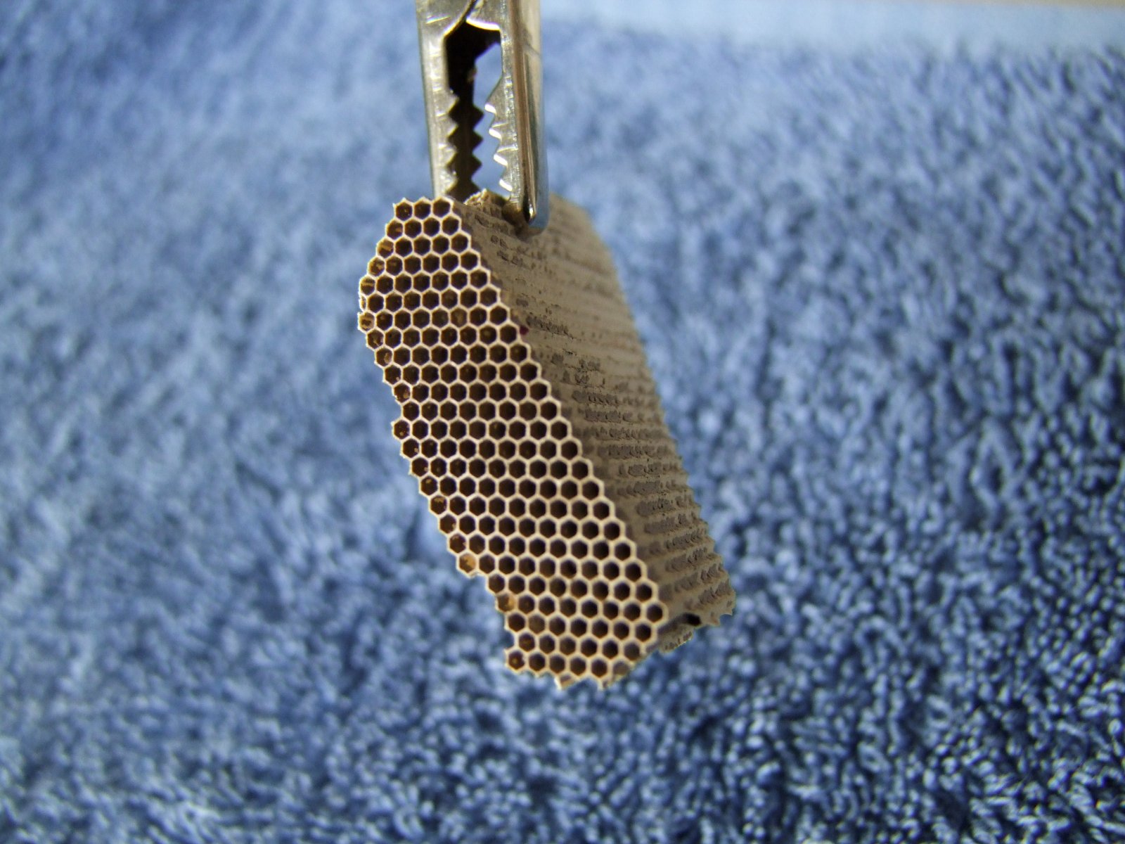

Just for interest, this was a piece of the ceramic honeycomb (diesel oxidation catalyst) from our 2003 Toyota RAV4 after about four years of use from new. It was 80% blocked with compacted soot, causing back-pressure which climbed as the revs rose, with the turbo making a chuffing noise as it vented excess pressure, and power dropping away.
? click to enlarge
Photo shows one of the clear parts. The hex 'tubes' are 1mm across, and run almost the complete length of the box (about 30cm in this case).
All this was on a 2.0L D4D running good quality fuel, dieselclean additive, and regularly doing lengthy fast motorway runs.

Thanks for that Chris. I do drive with a very light right foot so the soot probably tends to accumulate but I never had this problem with the other two 406s. I give them an 'Italian tune up' every now and again, especially on the way to the MOT but don't get a lot of soot coming out. I have done it with this one and again not very sooty. When it wouldn't pull the other day it was chucking out loads of black smoke but even after it cleared it still wouldn't pull. We have just done 2500 miles around the country without a problem, in fact this was the first time I filled it up since Asda in Tain about 3 weeks ago with 925.5 miles covered since the previous fill up, perhaps it objects to the change from Scottish to English diesel. :wink:
