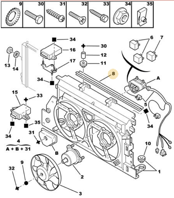

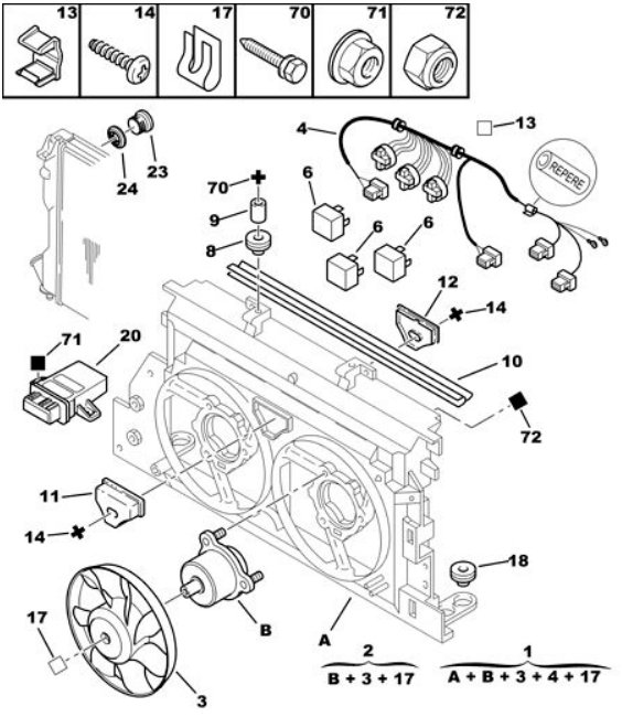

Here is the cooling fan setup on your Xantia - if you can identify the diagram numbers, I can get you the part numbers:
1250F1 is the combined parts in the second diagram on the right - that consist of B + 3 + 17. The price in the UK is £193.80 inc VAT and are still available.

I believe the assembly number is 1250F1 in your left hand diagram (mine has the reverse screw fixings as opposed to spring clips).
That part number also seems to correlate with Citroen 1253.64 and Nissens 85666?

The Fan Motor alone (item 2) ispart: 1253J7 and is £189.25 inc. VAT
The Fan alone (item 3) is part: 125467 and is £58.12 inc. VAT
