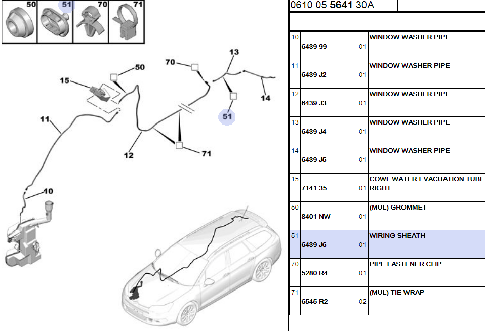

When I want to wash the rear window, the liquid go to the floor behind to right rear wheel instead of the window. Has anybody idea what is wrong?
x 6945
Re: C5 x7 rear washer
The tube has probably split or come off - it needs a replacement. They are available in small parts.
Here's the tubing: (click to Zoom)
