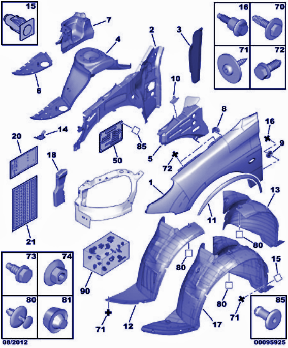

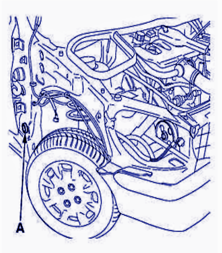

Ok, here you go: Click images to Zoom
Here is the Overview of the Wing Assembly and Associated Parts

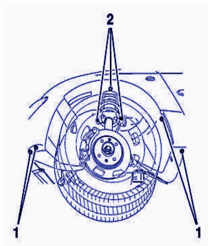

Remove:
  • The mountings (1)
  • The clip (2)
  • The mud shields

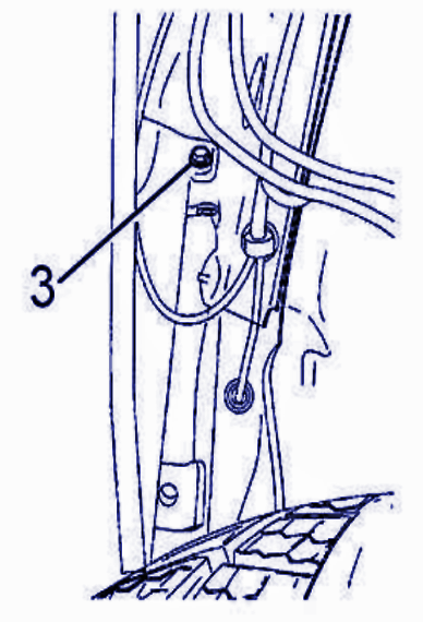

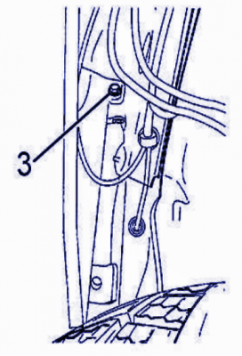

Open the door.
Slacken the mounting (3) passing via the interior of the wing.

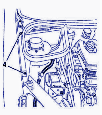

Remove the mountings (4).
N.B.: On the left-hand side (/): Secure the bonnet.
Remove: bonnet stay.

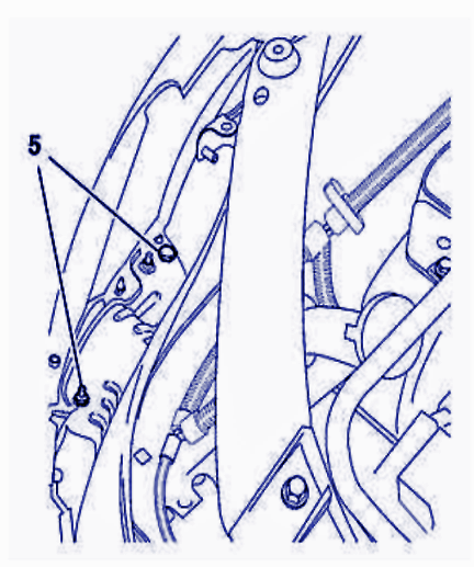

Remove the mountings (5).
Release the wing by removing it from its mountings.

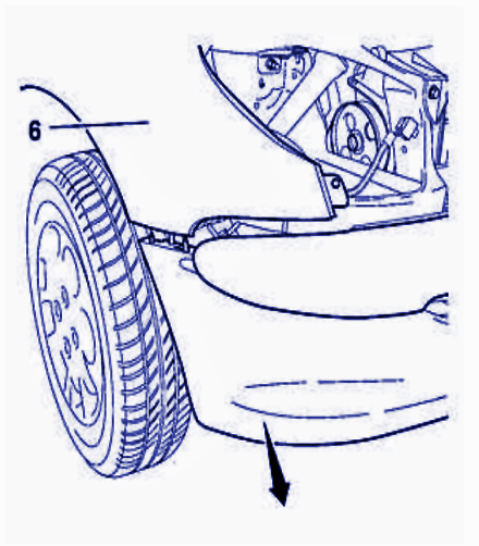

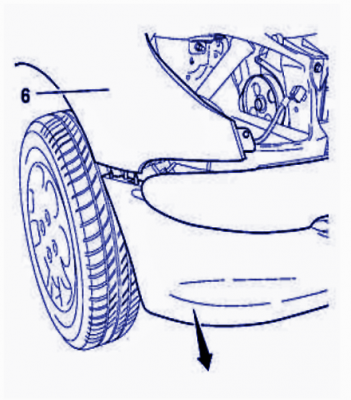

Press on the bumper .
Remove the front wing (6).

N.B.: On the left-hand side (/): Apply a 2 x 8 x 400 mm bodywork mastic filler and sealer
between the wing inner panel and the wing flange.
  • Insert the wing in the centralising stop (A).
  • Proceed in the reverse order to removal.
