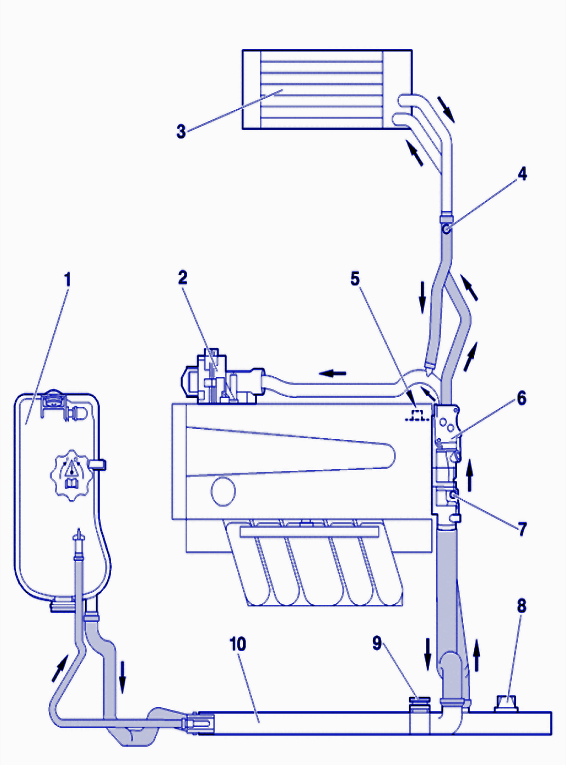

Here's the cooling system info. No mention of a drain plug on the water pump itself.
| Water Pump |

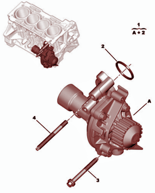

Will try but if you look at the exploded view, its the sort of round bit between bolt 3 and the cam belt drive pulley for the w/pump. If view from under the car its a "D" shape, but will try and get a picture over next time the car is at mine.
Anyone know the torx size of the stud 4 please ?

That being an 8mm stud I believe it will be an E10 torx socket you need...………..unless the French are playing silly buggers again.
