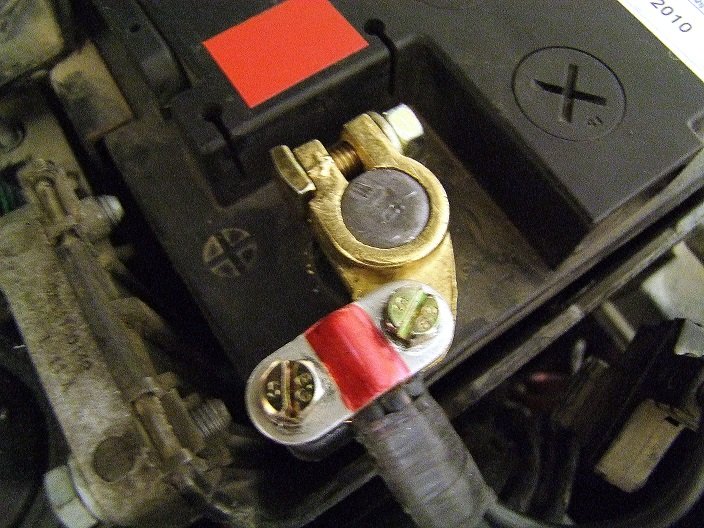

Check also the battery clamps themselves. If original lead (Pb) lumps, they can develop corrosion internally, and relax their grip on the cable strands.
A sign of the old lumps deteriorating internally is if either gets warm/hot after a bit of cranking.
Not a bad idea to replace them (now 15 years old!) if they're the originals. Brass ones something like these are a good idea: Cut off the old lumps, and clean up the cable strands (they may have oxidised/gone black) to clean copper.

white exec wrote: 13 Oct 2018, 17:15 Check also the battery clamps themselves. If original lead (Pb) lumps, they can develop corrosion internally, and relax their grip on the cable strands.
Agree with the brass clamps, it makes a battery that seems like its on its way out come back to life. I thought my banner battery nearly 8 yrs old was i need of replacement, earth lead would loosen up after a couple of months only 5 yrs later i sawed through the original lead clamp and fitted brass, ive never heard the starter motor so happy....
