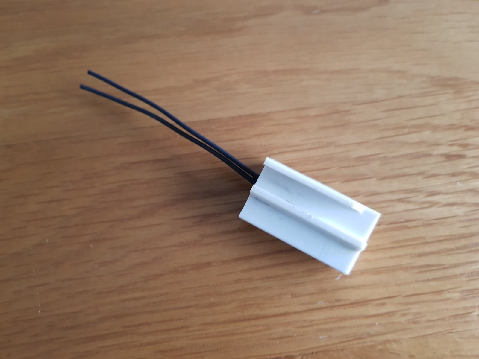

Hello all after a lot of messing about ive tracked down my issue with the fuel cap open that pops up all the time , have a look at the attachment this sits just below the magnet on the fuel neck and evidently when yr cap is off it breaks the circuit and tells the ecu that the fuel cap is off , when this sensor fails it says yr cap is off all the time , to prove its this I have simply cut the wires and twisted them together and bobs yr uncle everthing is good my question is does anyone have the part number for this part, I hate main dealers absolute rip off merchants

I believe this is the part
PEUGEOT 407 607 / CITROEN C5 C6 HDI FUEL FILLER NECK SENSOR HAMLIN

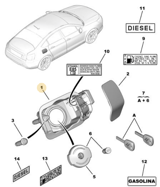

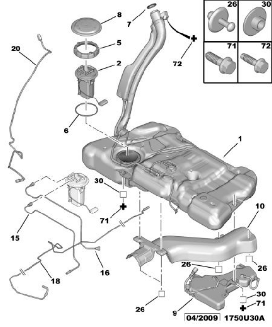

, so you have the C5 (X7) 4 DOOR SALOON 2.2 HDi particle emission filter 175 Manual gearbox 6.
So the plug presence detection harness is shown in the first diagram as item 20 and the fuel flap parts in the second diagram.
Item 20 is part number 6534PF and is £135.88 inc. VAT from Citroen.
It's quite important to get fixed as this helps the engine ECU determine if you have put any fuel in the car so it can dose the additive. Although the systems work slightly differently, the fuel tank is also used to determine the estimated quantity of fuel added. But the cap sensor is also used in the programme e.g.: has car stopped?, has car fuel flap been opened? - possibility of fuel added - check quantity after car is started and driven off - decide on amount of additive etc....

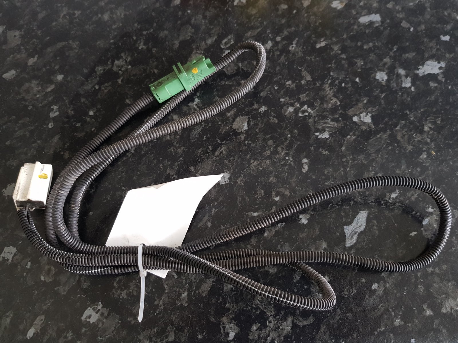

Hello all quick update on this is ive managed to track down a second hand fuel tank sensor .. so rip off Citroen wanted £135.88 inc. VAT I got the OEM part for.... £18 looks like new … the thing that really bugs me is its not as if the part is full of technology,, just a magnet to complete a circuit ..

I have the fuel cap open fault and tried to obtain the relevant wiring harness with the switch in it only to be told it was not available.
If anyone has information on where to obtain one I would be most grateful.

It depends on the exact vehicle engine specifications as some do and some don't have these. But importantly, you need to have it checked out as it may be the contact switch in the fuel filler cap that is faulty and not the harness if you have one.
Edit: Just seen you last post with your VIN - so yes you do have the plug detect harness and they are all the same for the C5 X7 models fitted with them if you are sure it is the harness.
