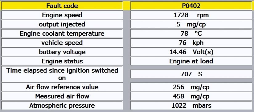

The freeze-frame data of this returning permanent fault appears to contradict the error code or am I missing something (I usually am!).

Re: C3 P0402 EGR Excessive Flow
If the Measured air flow is higher than the expected value then it looks like the EGR valve is jammed closed (would expect to see copy position faults in this case) or the EGR valve is blanked off.
What is the airflow readings when the engine is idling & fully warmed up ?
The airflow readings from the MAF are the ones im interested in, they are a good indicator of what the EGR is actually doing.
The OCR% readings are what the ECU wants it to do.
Thought it was an electric EGR valve on this engine so wont be any copy signal on it unless there are wires coming off the EGR valve itself, in this case it uses the MAF to know what the EGR valve is doing.

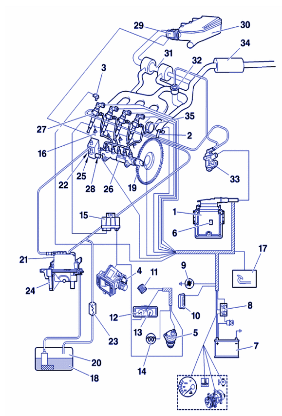

I'll get you the fuel system setup in a second which may help identify what it and isn't on the vehicle...
Electrical Circuit
Fuel System
Air Circuit
Electrical Circuit
| Component | Reference | Remarks |
| Diesel Injection ECU | 1 | - |
| Engine Speed Sensor | 2 | Tightening torque: 5 m.daN (min.) and 10 m.daN (max.) Black 3-way |
| Position Sensor (A.A.C) | 3 | Adjust the airgap of the camshaft position sensor 1,2 mm Grey 3-way |
| Engine Coolant Temperature Sensor | 4 | On the coolant outlet housing |
| Vehicle Speed Sensor | 5 | - |
| Atmospheric Pressure Sensor | 6 | Incorporated in the injection ECU |
| Battery | 7 | 12 Volts |
| Injection Double Relay | 8 | Integrated with the engine fusebox |
| Diagnostic Warning Lamp | 9 | Incorporated in the instrument panel |
| Centralised Diagnostic Socket | 10 | Passenger compartment interior |
| Transponder | 11 | Transponder integrated with the BSI and engine ECU |
| Consumption Information | 12 | Incorporated in the instrument panel |
| Tachometer | 13 | Incorporated in the instrument panel |
| Heating Warning Lamp | 14 | Incorporated in the instrument panel |
| Pre-Post Heat Box | 15 | - |
| Pre-Heater Plug | 16 | - |
| Accelerator Pedal Sensor | 17 | - |
Fuel System
| Fuel | 18 | Diesel |
| High Pressure Fuel Sensor | 19 | - |
| Fuel Tank | 20 | Capacity = 45 litre Composition = Polyethylene |
| Fuel Filter | 21 | - |
| Low Pressure Regulator | 22 | Fixed to the high pressure fuel pump |
| Fuel Cooler | 23 | - |
| Fuel Heater | 24 | Integrated in the fuel filter cover |
| High Pressure Fuel Pump | 25 | The high pressure fuel pump is driven by the timing belt |
| Fuel High Pressure Common Injection Rail | 26 | - |
| Diesel Injectors | 27 | Piezo-electric controlled diesel injectors |
| High Pressure Fuel Regulator | 28 | Fixed to the high pressure fuel pump |
Air Circuit
| Component | Reference | Make | Reference | Remarks |
| Air Flow Meter | 29 | SIEMENS | 39071LS.F | - |
| Air Cleaner | 30 | MECAPLAST | 50557LP.A | Incorporated into the inlet manifold |
| Turbocharger | 31 | KKK | Type KP35 | - |
| Exhaust Gas Recycling Valve (EGR) | 32 | SAGEM | Type 2580132-A | - |
| Recycling Regulation Electrovalve (EGR) | 33 | - | - | - |
| Exhaust System | 34 | - | - | - |
| Vacuum Pump | 35 | - | - | - |

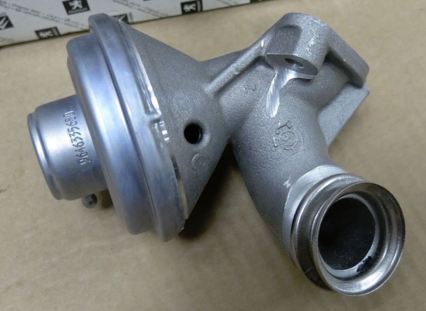

- x 6957

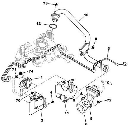

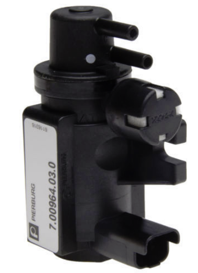

Here's the EGR - doesn't seem to be electrically operated for this part (1628XV), but what about the electrovalve (number 33 on the diagram)?
Following a 15 mile round trip the results are....
Air flow matched Referenced flow almost to the digit throughout all driving ranges while the EGR commanded OCR% value never deviated from a constant 5%.
Although I do not have P0406 registered, todays data does appear to show the ECU backup mode of cutting EGR regulation.
Guess I should have cleared the fault first?
Yes it does have the EGR regulation valve (33) fitted to the front left side of the engine with all connections in place.
- x 6957
So is there sufficient vacuum being generated Mike?
I really don't want to have to test it at this point if it's not necessary. Besides, if the ECU has cut regulation and as the live data shows a fixed OCR 5% then I would expect to find no vacuum supplied to the EGR valve anyway.
I think i shall just have to wallow in my ignorance and leave it closed.
