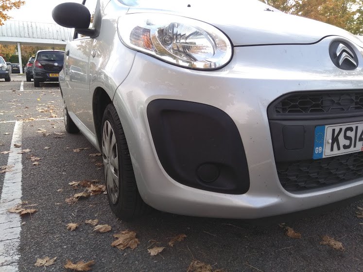

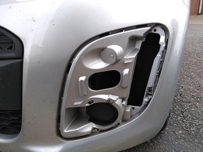

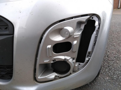

daughter had a close encounter with a little deer in her C1 the other day... No damage except the the LH dummy foglight/DRL panel popped out and disappeared :lol:
Grateful if someone with access to service.citroen (or whatever it may be called now) could look up the part number and cost for me please?
I attach a couple of piccies of the missing panel and the matching RH one...
C1 is a very late 2014 model...
Thanks :D

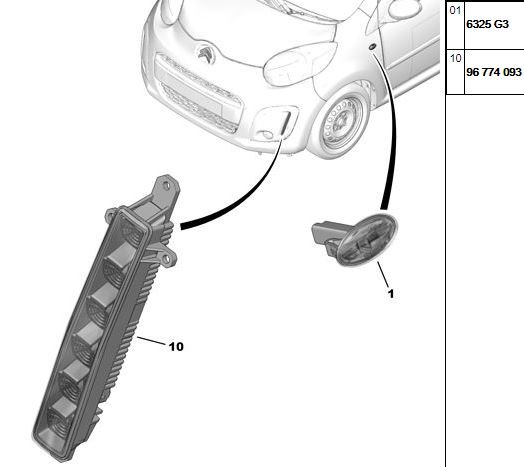

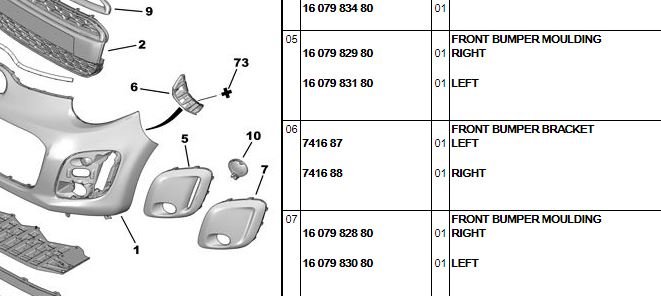

Looks like there are 2 options - from the diagram it appears the only difference is a small slot in the outer edge, which it doesn't look like yours has, which makes it part no 7? If you can post the VIN (which will cunningly hide itself!) then I can confirm which one.
Costs from Citroen:
Part Number Description Quantity Price excl. VAT Price incl. VAT Total incl. VAT Selection
1607983080 BUMPER MOULDING 1 30.08 GBP 36.10 GBP 36.10 GBP (Item 7)
1607983180 BUMPER MOULDING 1 22.02 GBP 26.42 GBP 26.42 GBP (Item 5)

That slot would be for the DRL (where fitted)?

xantia_v6 wrote: 09 Oct 2018, 07:32 That slot would be for the DRL (where fitted)?
Yes, looks like you are right Mike!

The car is a real poverty-spec C1 and has no DRLs although Robyn did notice all the wiring is in place for them!!! Price is a bit steep for a bit of flimsy plastic but at least the bumper escaped unscathed :)
