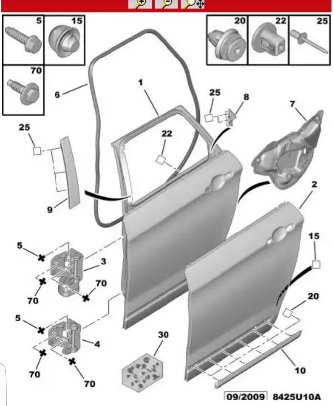

Hi Has anyone any tips on replacing the chrome trim ( Item 10) ??

There are 6 clips. These are 'side mounting' clips - so probably slide on into a channel on the inner side of the chrome trim and press into the door. A normal blunt trim removal tool is used to remove them. Caution though - If replacing the trim, I would ensure you have some replacements as they may very likely snap on removal, as you pull them out.
