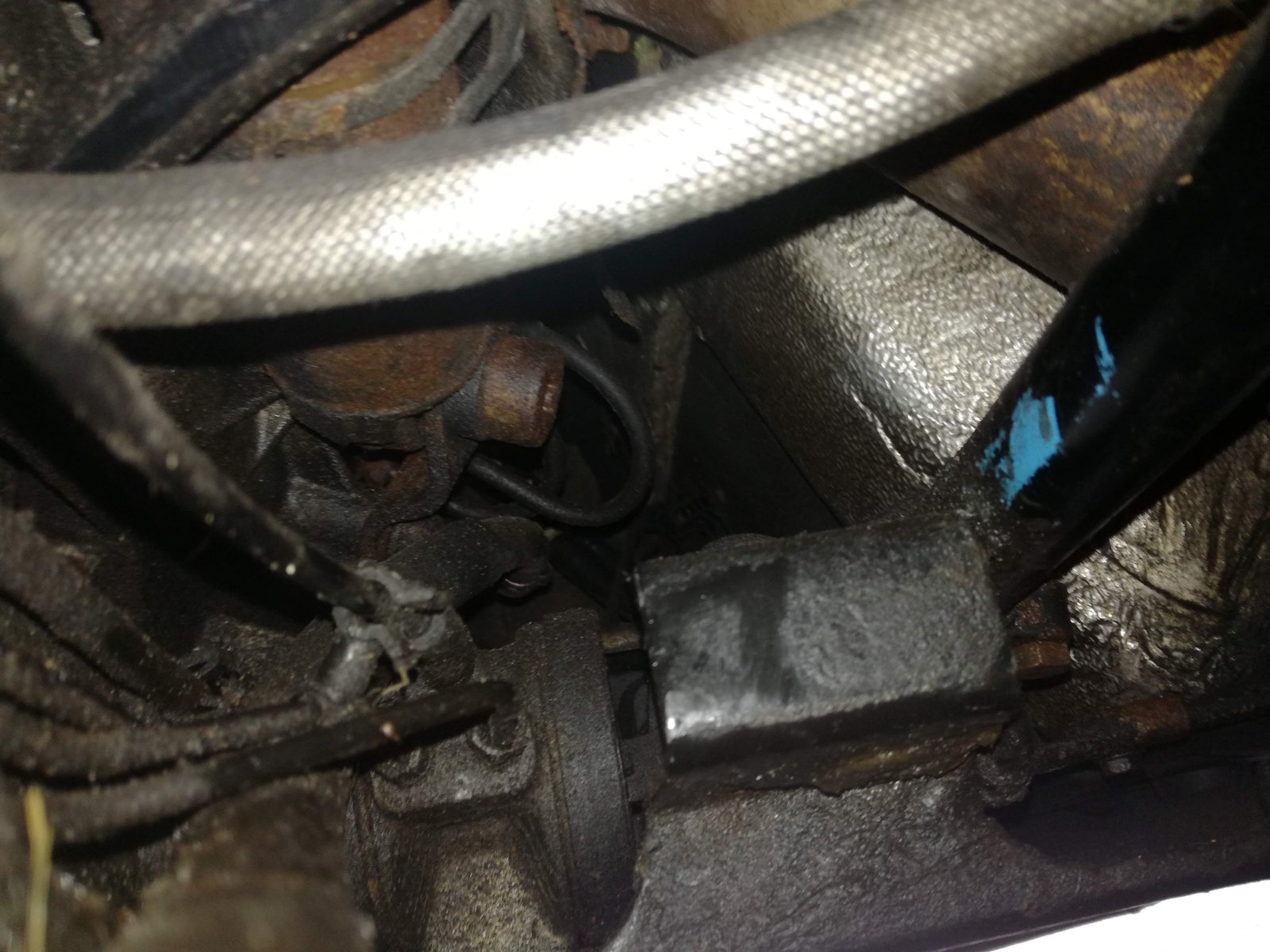

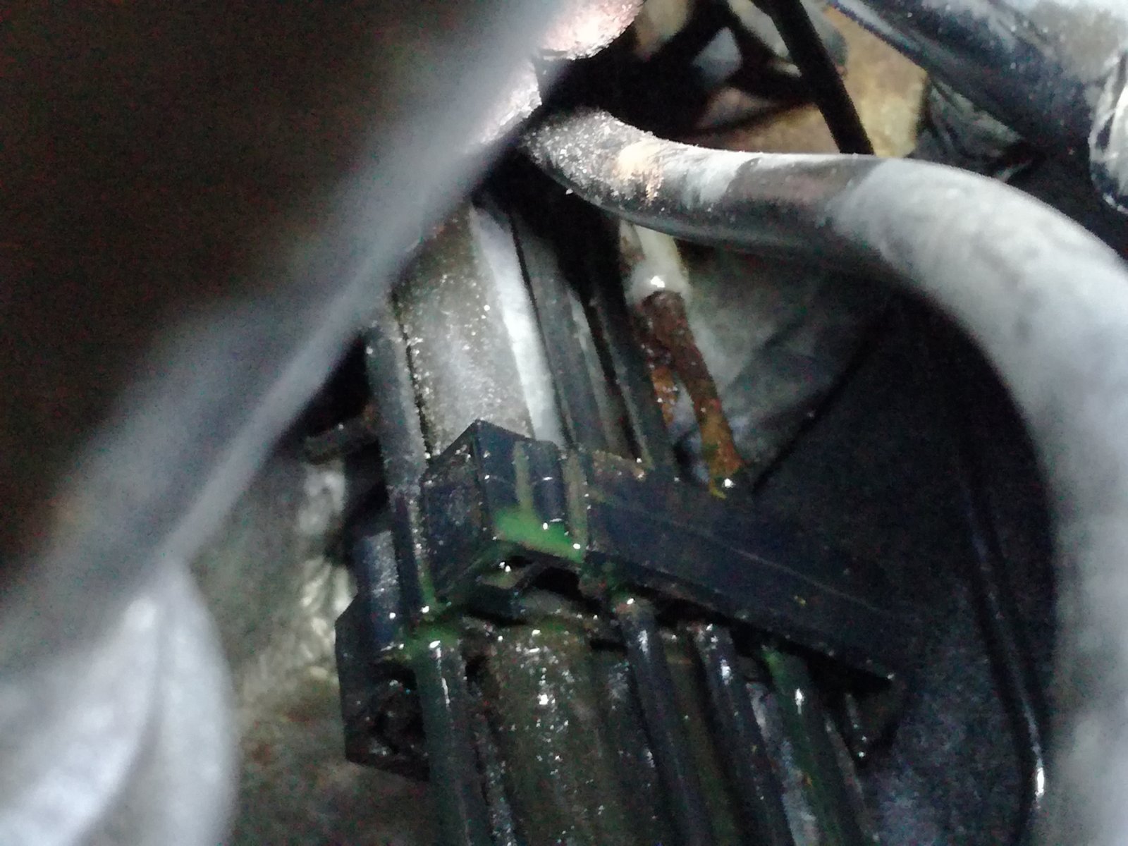

I managed to get a picture - I think the leaking pipe is the one on the right of the three together just above the plastic? guide piece. You can see it looks corroded and has a small piece of metal flaking off it.
Thanks in advance for any input.

Can you get a shot from further out (or a description) so that we know where it is?

xantia_v6 wrote: 05 Oct 2018, 17:25 Can you get a shot from further out (or a description) so that we know where it is?
It's taken from just inside the nearside front wheel looking upwards towards the centre of the bulkhead.
I'll try and get a wider shot tomorrow (weather permitting - it's forecast to be wet and chilly).

It may be that the metal pipe goes into a rubber hose that has either split where it bends further up or maybe just the locking clip seems to be missing in the photo where I would expect to see one
I had a similar pipe go when I done my gearbox (mine was perished rubber return hose - low pressure)

Before I start removing things can anyone confirm that the suspect pipe is indeed a return line to the tank?
It is the right hand one of the two shown in the photo I took earlier.

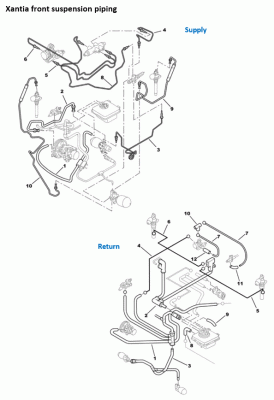

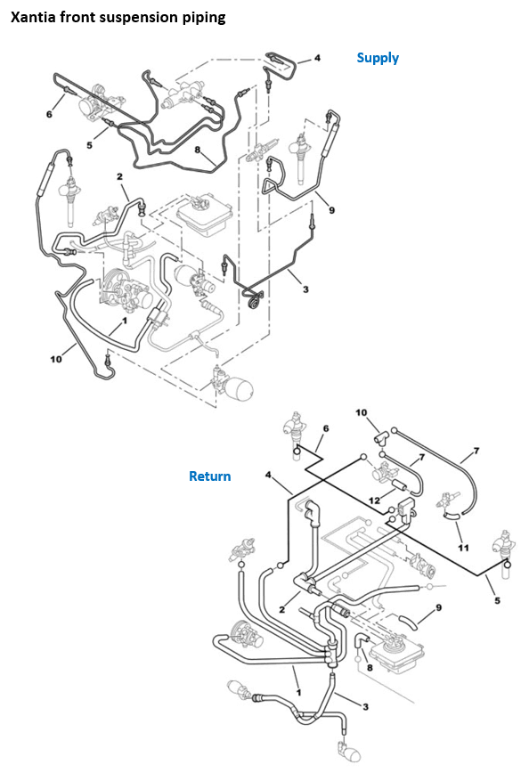

A diagram of the height corrector plumbing would also be useful.

Re: Xantia Exclusive HDI 110 leaking LHM from pipe behind engine
Try the attached - best I can do; hope it helps
