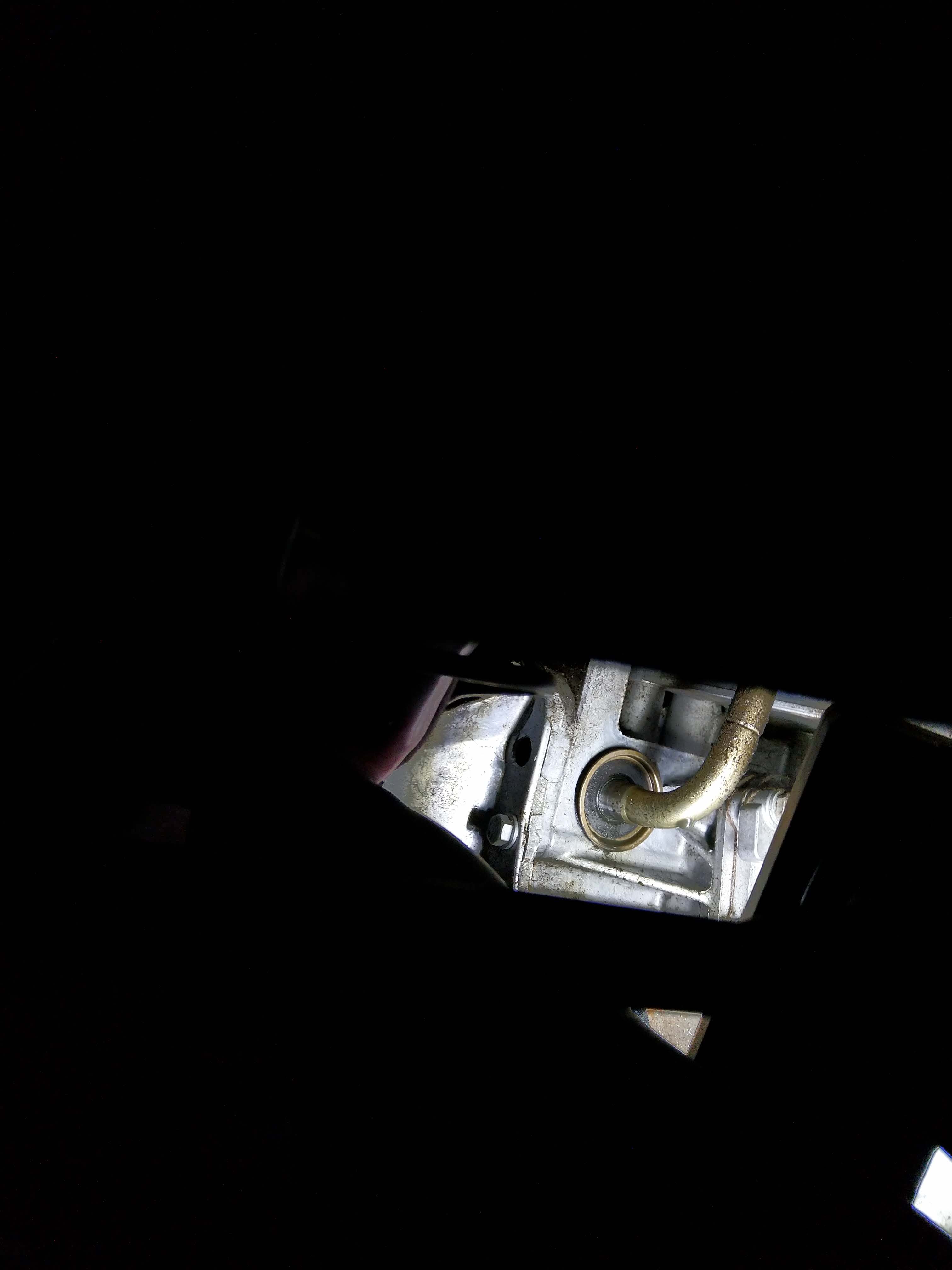

So, car is a 2011 C4 1.4 VTi and there is a slight leak on the gear selector rod seal.
Looks like this
Can the seal be changed(it's available to buy on citroen.service) without disassembling the gearbox?

That has to be one of the most dramatic photos posted here for some time! :wink:

Haha, that was the only way I could make it somewhat visible :mrgreen:
