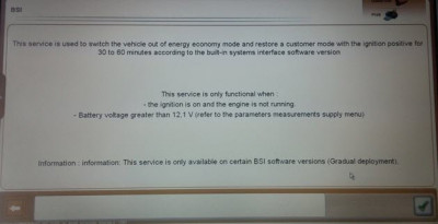

What are the steps in Diagbox to turn off economy mode while connected to the diagnostic software so you don't need the engine running all the time?

I think it’s in the BSI configuration Stu, but can’t remember now. Check out the options there first though

I think I stumbled onto it through the Repair option, Stu.

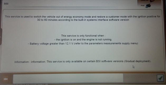

Thanks Mike, yep, found it as Marc said in the BSI menu,
  • BSI - Operating Mode
  • Exit Economy mode
Then you get this message
Then you click on the green tick to validate
