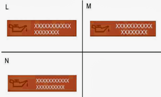

Sorry a typo! I have swapped keyboards and the keys are all over the shop - should of read gauge
As a temporary measure and until you can get a spare dip stick (Part number: 1174G9) these are the indications of the Oil gauge.
  • "L" Correct oil level
  • "M" Fluid level: Incorrect
  • "N" Fluid level: Not valid

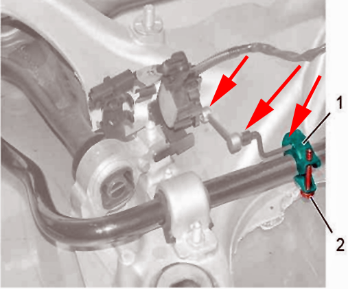

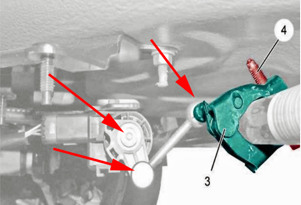

As for the height correctors: be very careful not to disturb these by turning them or moving them - they are set at a specific angle on the rear anti roll bar and on the front - rotating these will cause the height references to become out of kilter.
Make sure there is a little grease on the areas I have marked in Red and then work the suspension up and down a few times. (but not while you are under it obviously).

If greasing and exercising it doesn't work then, with the car firmly supported on ramps/axle stands etc. then try unplugging the sensor ( just a posh potentiometer), cleaning the contacts and spraying with Servisol or Isopropanol, work the plug in and out a few times too to help remove any corrosion and make a good contact.
If that fails it will probably need a replacement sensor, about £30 from the dealer.
I have a vague recollection that someone dismantled and cleaned one that then worked OK - no idea how long for but they have been found with burned-out tracks so beyond repair.
