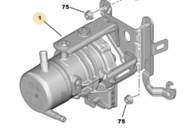

Ok, your rack is indeed the electropump variant. So the system is fed LDS fluid directly from the power steering reservoir, but is electronically operated:
