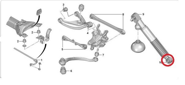

Hello!
Need help please, case is: Citroen C5 2008 tourer 2.7 HDi , is there available rear shock lower bushing. Original Citroen parts diagram not show any bushing repair parts of shocks?!

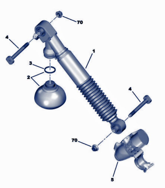

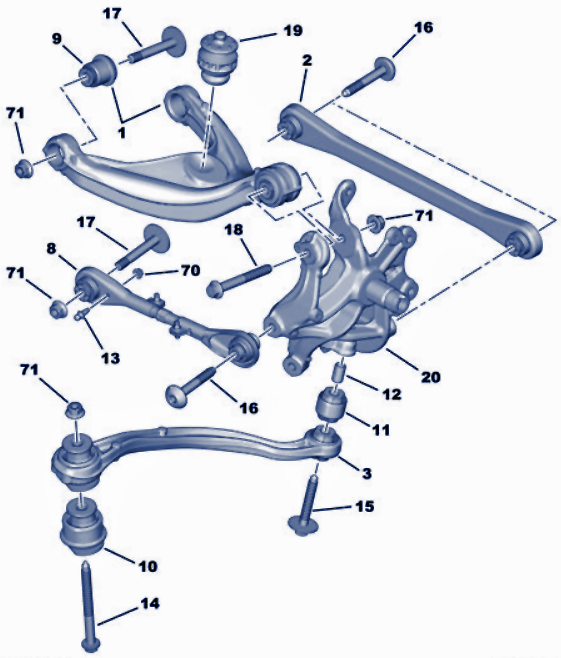

Re: C5 2008 rear shock bushing?
Not that I can see from the diagrams:
Unread post by JIITEE »
How to fix those bushings?! New cylinder with spheres cost about 315€ each so i really want fix those bushings??!!
JIITEE wrote: 27 Sep 2018, 15:16 How to fix those bushings?! New cylinder with spheres cost about 315€ each so i really want fix those bushings??!!
A new one in pounds sterling is £212.62 inc. UK VAT - but they don't do a bush - it's a new strut - so if you are determined you will have to experiment.

JIITEE
Posts: 21
Joined: 13 Aug 2018, 01:08
x 2
Bingo! :
https://www.euspares.co.uk/parts/tedgum/12209188
I have to double check dimensions before order those..
Well , good thing is that i finally found suitable bushing. And even better thing was i found those in one shop when i spend few minutes in google..now just have to wait parcel to arrive
