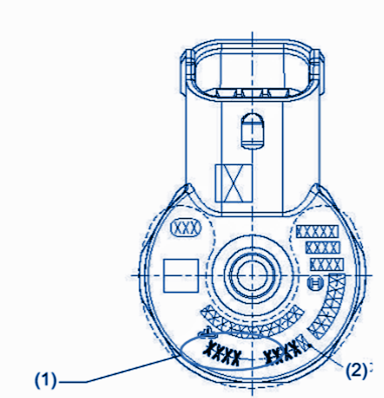

I have just got a 207 running with a new injector but PP2000 wants an 8 digit code and the injector has 10 digits on the sticker. The original injectors have 9 and the last digit is simply dropped when programming but I don't want to guess how which 8 digits to use and cause an issue.
Any information would be great. Thanks.

Here you go: So basically just enter the first 8 characters.
| INJECTOR CONFIGURATION (1) Location of the 8 characters (2) Location of the ninth character There are 2 types of injectors:
The diagnostic tool allows you to programme either: 8 characters - Conventional for 1st generation injectors for 2nd generation injectors the last character (2) does not have to be taken into account. or: 9 characters - Enter all the characters present on the injector. |
