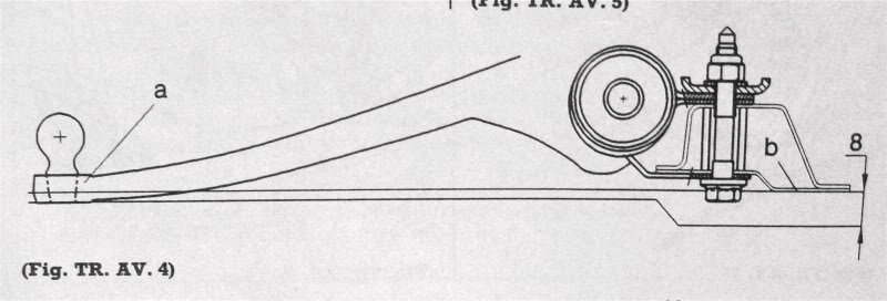

Re: Xantia hdi Bushings
Am sure the guys will help but the bushes Do need to be fitted correctly inline with Normal ride height, there is a picture about that exains it,

Timmo
- Posts: 1346
- Joined: 11 Jul 2011, 15:41
- x 168
Knew i would find ot somewhere!

xantiagreen
- Posts: 393
- Joined: 13 Sep 2013, 04:45
- x 2
Timmo wrote: 03 Oct 2018, 21:15 6ac6e19333099f4071085ab3cee424af.jpeg
Cheers will mention to mechanic when i see him..

- Posts: 14308
- x 3306
