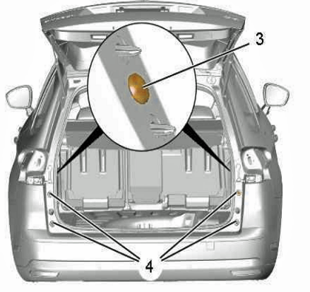

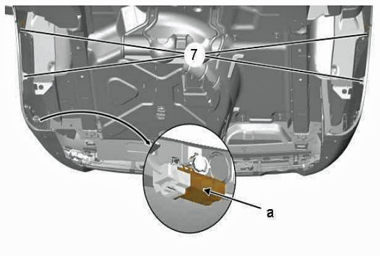

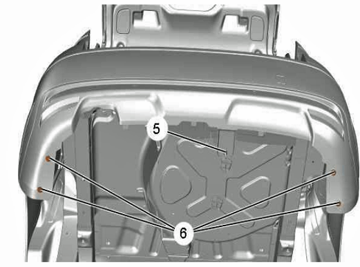

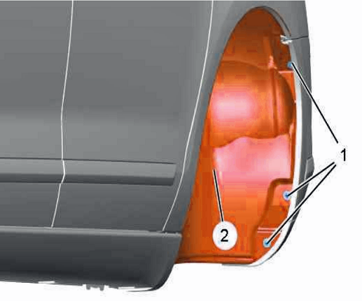

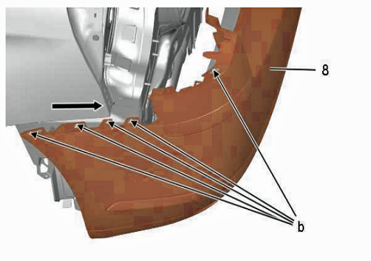

The official guidance is to remove the bumper first - I have included this for you in the table below. Guidance also suggests for bumper removal that the rear wing lamps are also removed - but whether you need to do this you can determine or not as you proceed.
Clicking on these images should zoom then up a little
| Remove: The rear wheel The bolts (1) Partially disengage the rear splash-shield (2). | Remove: The bolts (3); From inside the boot The bolts (4) |
| Remove: The bolts (6) The nut (5) | Remove the bolts (7). Disconnect the connector ( as "a") (according to equipment). |

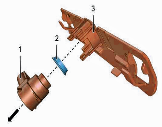

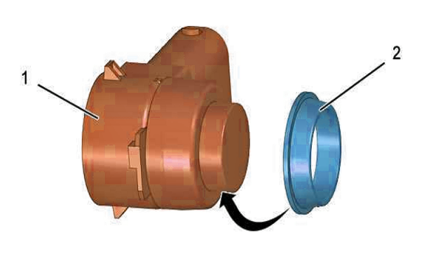

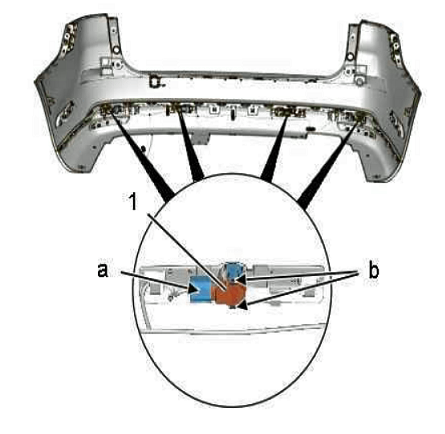

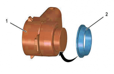

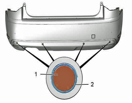

| Unclip the rear bumper (8) ( as "b") (on each side). Remove the rear bumper (8) (following the arrow ). Refitting Proceed in the reverse order to removal. Tighten the bolts (3), (4) to 0,4 ± 0,1 m.daN . Tighten the bolts (7) to 0,2 ± 0,05 m.daN . Tightening of the wheels: Aluminium wheel rim: 9 ± 1 daNm Steel rim: 11 ± 1 daNm | For the following operations proceed identically for the 4 proximity sensors. Disconnect the connector ( as "a"); Using a trim tool. Unclip: The clips of the sensor (1) ( as "b"); One by one. |
| Do not rotate the sensor, Do not drop the sensor, do not hit the membrane, do not use a sharp tool, do not push an instrument into the resinous part, do not touch the connector, do no apply any lateral or rotatory force on the external ring and membrane of the sensor. Disengage the sensor (1) with the ring (2) from the support (3) in a straight line (following the arrow ). Remove: The proximity sensor (1) with the ring (2). | Refitting: Check the presence of the rings (2) on the proximity sensors (1). |
| Refit : The proximity sensor (1). Check that the ring (2) is positioned correctly on the support (3) of the proximity sensor (1). Proceed in the reverse order to removal. Check all the equipment works. |

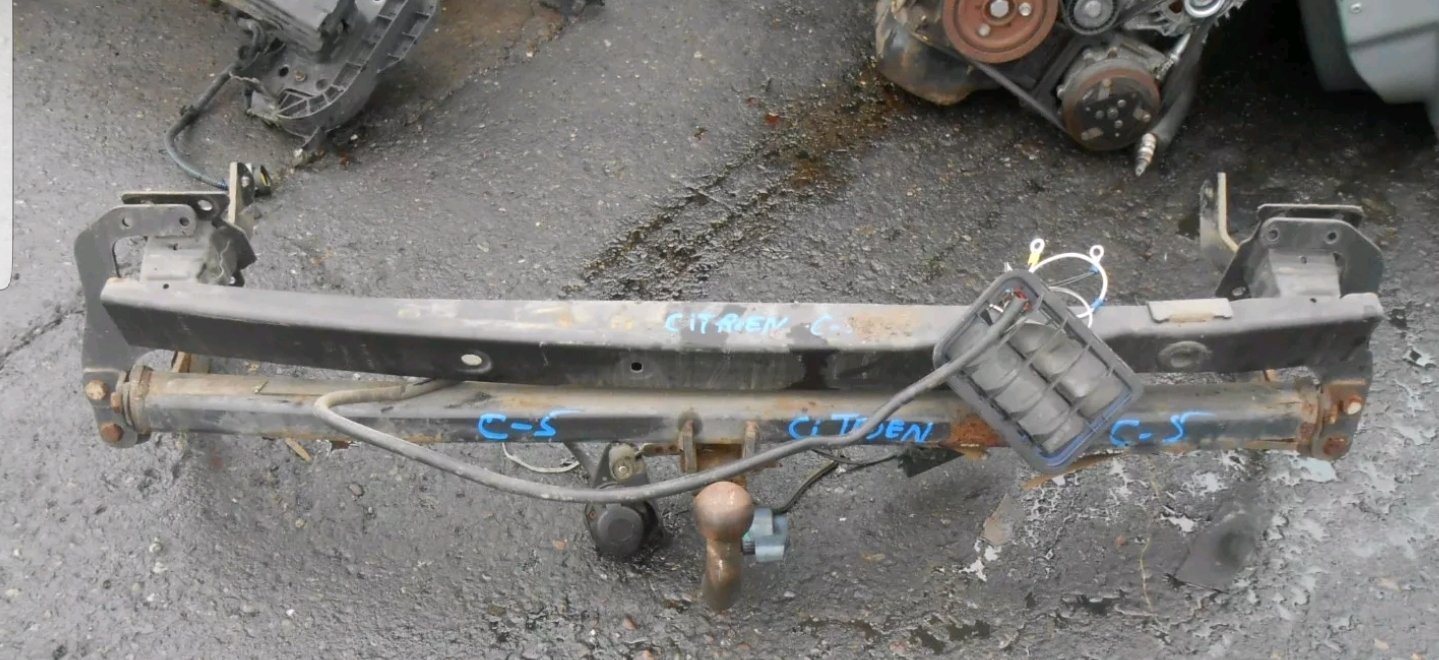

Jim66a
- Posts: 41
- Joined: 16 Sep 2018, 11:35
- x 9
Re: C5 x7 tourer rear bumper removal
This looks like mine
- Posts: 9369
- x 1939
I'm not at all sure that's an OE bar despite it having a removable ball. What other information is written on the towbar ID plate?
Having said that, the bar in the photo certainly looks like it still has the armature.

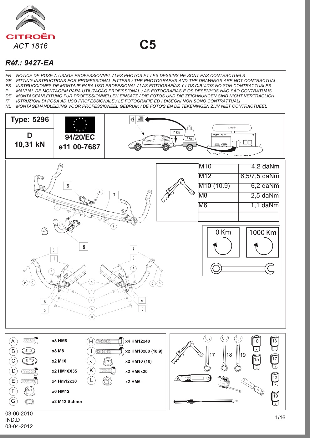

Here’s the outline of the 9427EA:
Click to Zoom
Click to Zoom

That's different to my bar. Looks like my info is duff.
Jim66a
- Posts: 41
- x 9
I have asked the breakers, Where the photo is from, If the tow bar still has its part number badge. Although it does look to be in poor condition.
