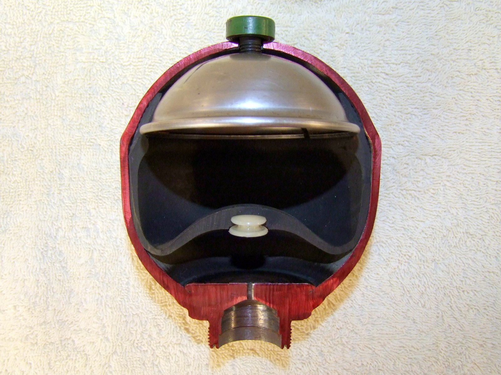

Sphere life for the classic spherical type (green or grey) is up to 5 years as a rule, but can be longer. Accumulator and anti-sink (if fitted) can go on for much longer. It's time that does for spheres in the end, rather than mileage, as the nitrogen eventually permeates through the 'rubber' diaphragm, and disappears into the LHM.
As gas pressure reduces, the suspension gets very gradually firmer, until very little springing is left. At around 10-15 bar, the ride is extremely firm and bouncy, and below that there is the likelihood of the diaphragm rupturing, as it is forced against the metalwork inside the crown of the sphere. With little or no gas pressure left (a 'flat' sphere), the only springing left at the heavy front of the car is the rubber of the strut-tops, and a severe bump can cause these to shear. At the first sign of bouncy or bumpy ride, it's time to investigate.
The photo above is of an Accumulator sphere. Corner (wheel) spheres have an additional damping valve fitted into the threaded neck of the sphere, and this damps the movement of fluid into and out of the unit.
For these classic spheres, it is good practice to have their gas pressures checked every three years, to make sure they haven't fallen to an unacceptable level. Almost no main dealers now do this, but some independent Citroen specialists have the kit to do it (the spheres are first taken off the car), and can also offer a re-gassing service, where the sphere is topped up (to the correct figure) with additional nitrogen. Re-gassing is not expensive, and may be worth while if you have bought expensive (genuine Citroen) spheres. DIY re-gassing kit is available (for about €150) if you want to check pressures and re-gas yourself.
