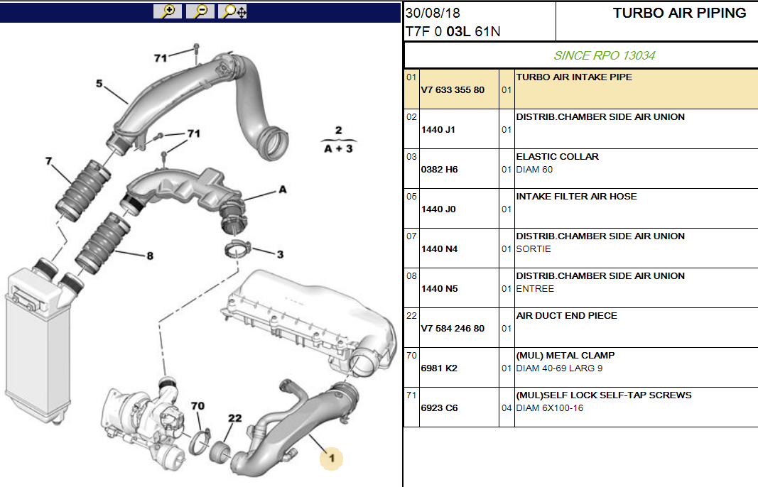

I think you are referring to the 'Air Intake Resonator' on a petrol - number 8 on the diagram:

No, that diagram only shows the pre-turbo plumbing, the pipe I am referring to is the one going across the top of the engine on the left here:

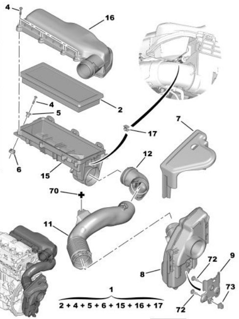

x 6948
Re: Inlet valve cleaner.
I thought this was the Turbo air intake:
