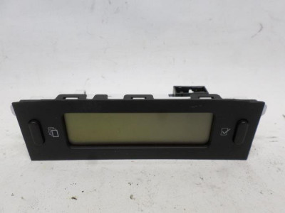

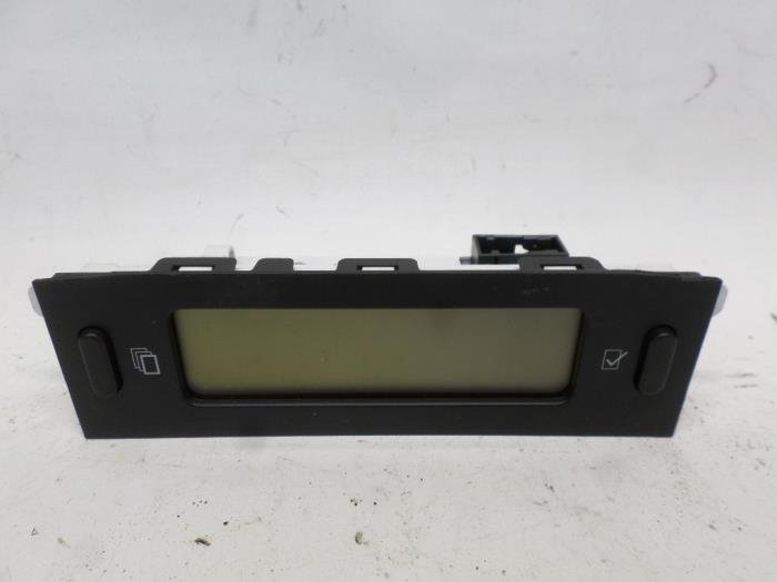

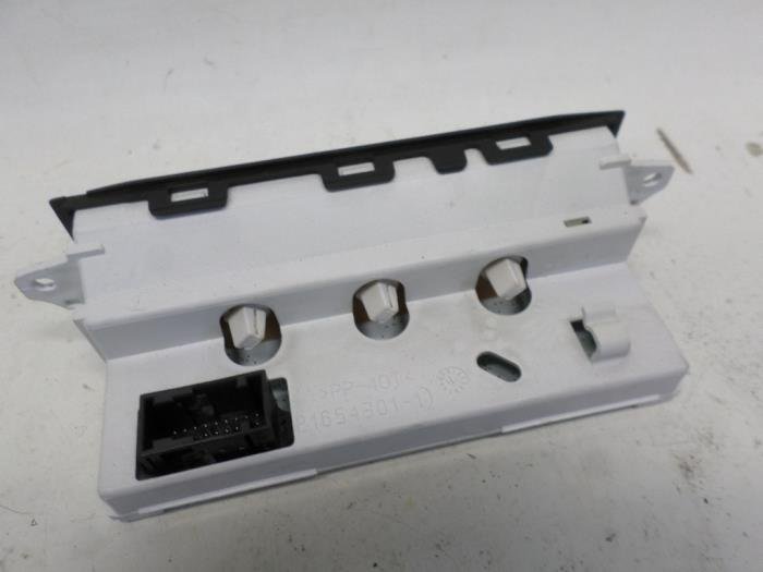

@ haroon88: Can you provide any pictures of the part in question?
haroon88
Posts: 8
Joined: 08 Sep 2018, 13:50
Re: Citroen C3 - Removing electrical connector pin from the display
Unread post by haroon88 »

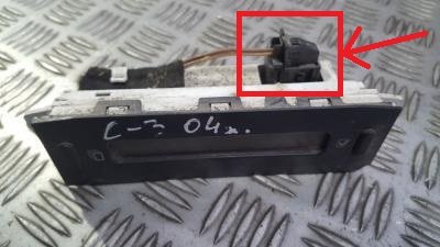

Thank you for all your replies. Sorry if not understanding the device which I was referring. Here are the photos. It seems quite difficult for me and I feel ashamed as it might be simple to remove but I am not understanding how to unplug it :oops: .
MikeT
Posts: 4808
Joined: 11 Jun 2007, 16:17
x 232
Unread post by MikeT »
The lever needs to be pushed down 90degrees (towards your arrow, right) so it's flat. There is stubborn resistance to this initially as it's clicked to lock, but once moving the lever action will also make the connector rise and disgengage from the socket pins.
