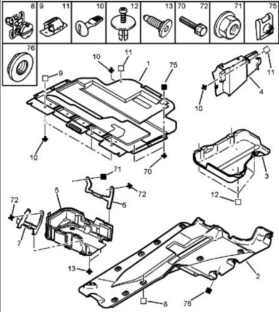

What actual bit is it? Part of the under engine protection??
The only 'Air Deflector' is listed for under engine protection - item 2 as wind deflector:
The only 'Disc Protectors' available are for the rear discs and not the front on your car:

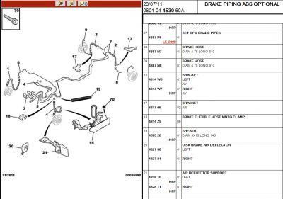

It's 4828.10 I think. An artist's impression.... (item 21) although there's another bit that goes with it (item 20) which is still available.
x 6957
Re: Any chance of a picture please.
That makes more sense :lol:
Air Deflector Support - top marks Richard!

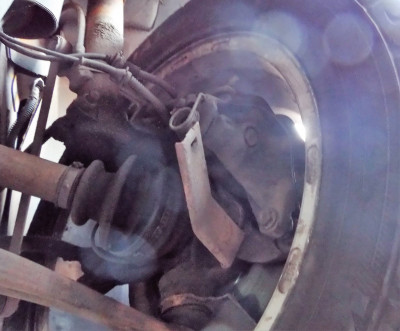

Well the rain stopped so I popped out and crawled under with the camera. Anyone know of one going spare?
Storeman at my local dealer says that he's never seen or sold one.

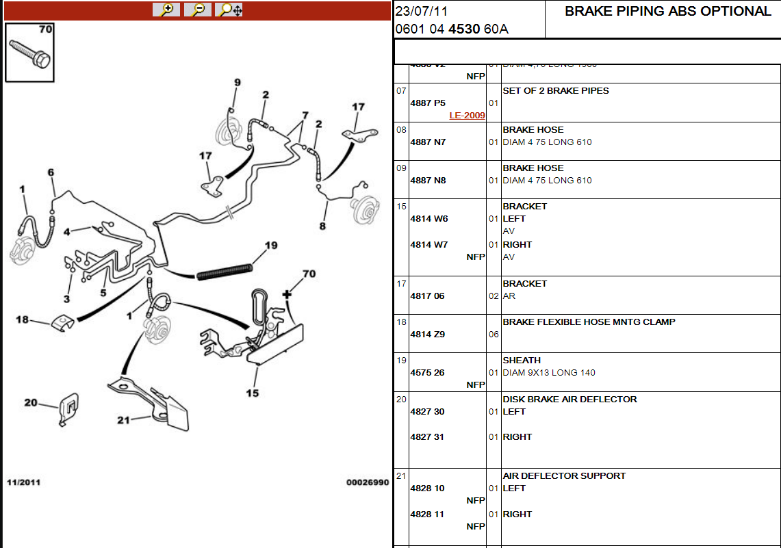

According to the parts they are listed as 'Optional' Gibbo, so maybe that is the reason:

Try aiming this part no at the spares man:
Part Number Description Quantity Price excl. VAT Price incl. VAT Total incl. VAT Selection
0000482730 BRAKE AIR DEFCT 1 7.5 GBP 9.00 GBP 9.00 GBP

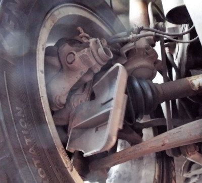

Resurrected this because I managed to finally find the part in Estately's lisy of goodies on here, so I crawled under there to fit it and Oh Sh**! the one from the right hand side has now disappeared.
:( Can I get the part number for the RH one please?

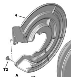

According to the diagram above, LH is 4827 30, and RH is 4827 31 .
