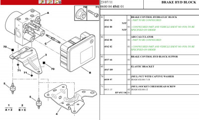

Re: C5 ABS warning light - advice please
Ok, no need to spell,it out Brian, I can see it fine - it’s part of the filtering we use to protect the VIN from public view.
Click to Zoom
Here you go, the hydraulic block and the ECU can be separated. The Hydraulic block is part 454154. This is specific to your car. The ECU is 454280.
Click to Zoom
Thanks for that.
I went as far as separating the motor, valve block and the electronics module (2 bolts and pull it apart). The helful guy I spoke to said that there are two parts within the electronics module that arer connected just by being forced together (I imagine much like the tiger tail used to connect a PCB to a liquid crystal display if that makes sense). He didn't tell me how to access the electronics unit and it would appear looking at on-line vids that it's a case of using a saw or a Dremel with a thin grinding wheel to cut the lid off. I also had difficulty removing the motor from its casing to inspect the brushes so all-in-all I'm thinking it might eventually be much more expensive if I screw it up.
