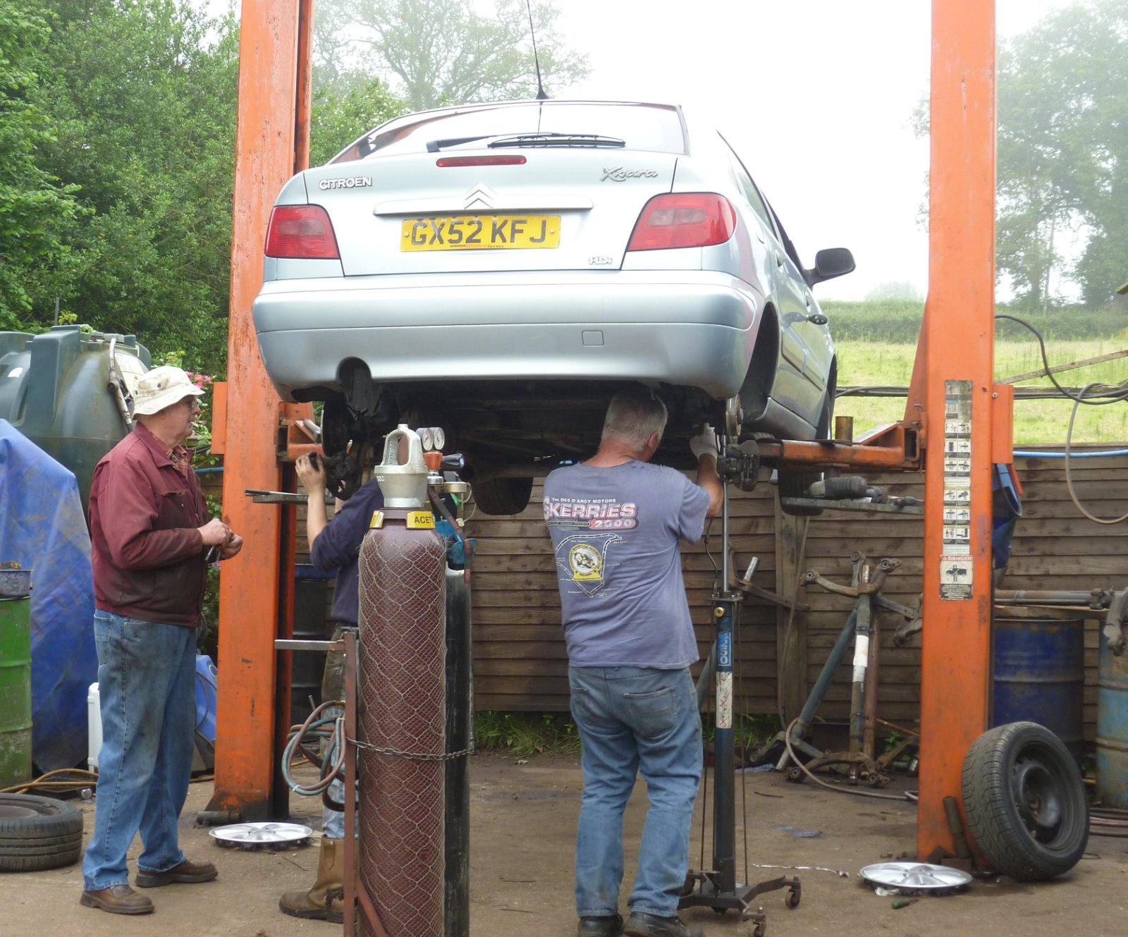

5 or 6 years ago I noticed the rear wheels starting to rub the arches along the top edges of my daughter's Xsara. It was time to get new bearings in the axle. I found online engineers who would supply an exchange axle and amongst them was a company in Devon who offered to fit an exchange at the same price as a delivered one. I decided a day spent driving down to the West Country was preferable to laying under the car. I made an appointment and left early and was there by 9.30. I spent a pleasant morning drinking coffee and chatting to the elderly guy who ran the workshop. By mid-day I was on my way home. The elderly guy (standing on the left) has probably retired now but my guess is that this company - http://abaxles.co.uk/en/about/ - is his engineers who have started their own business.

thanks for that and it's in chard now which is just up the road from my friend so handy.
