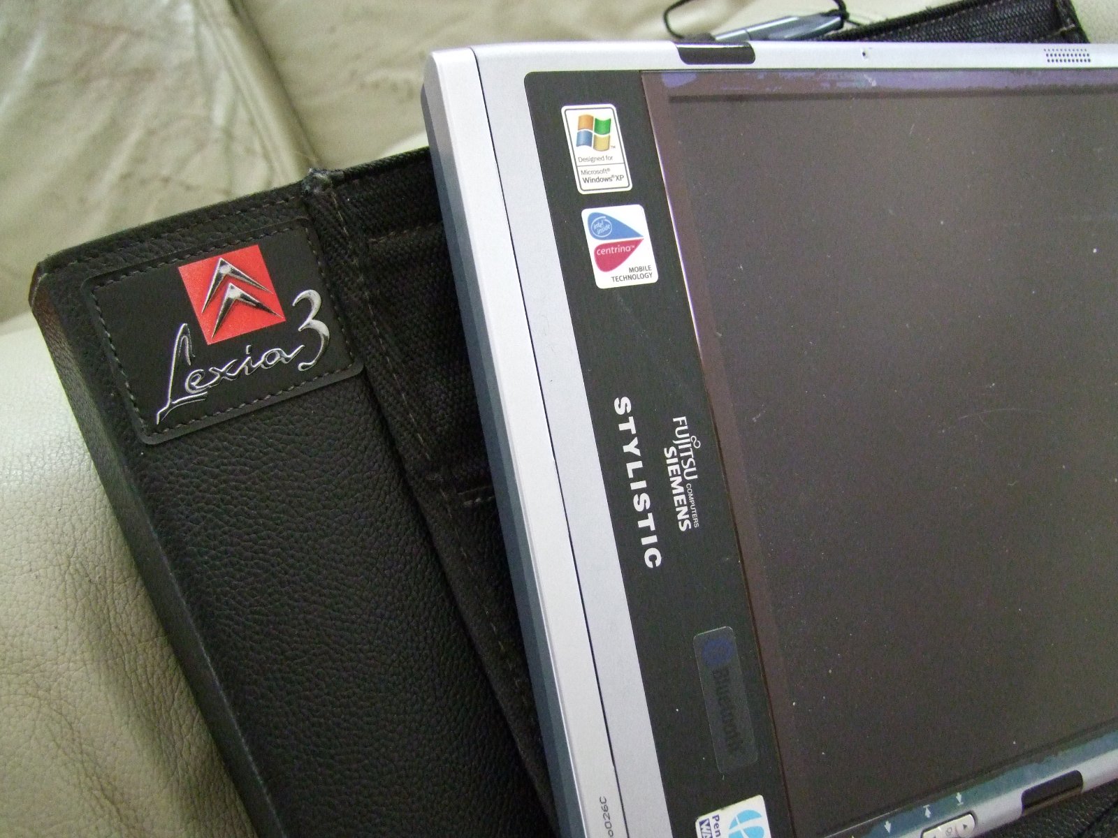

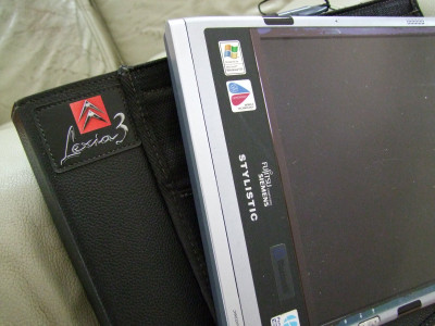

Quite an ancient device now - they date back to 2005!
In genuine Citroen workshop strip.
Bought secondhand from Normanlindley, of XM/C6 renown. He kindly brought it to Andalucia one day for a demo, and I liked it so much that . . .
Spec here:
http://www.computer-specifications.com/ ... Specs.html
or
https://www.cnet.com/products/fujitsu-s ... hdd/specs/ - scroll down past all the dots!
Runs WinXP. 2 x USB, which I use one for OBD link, one for a small keyb (can't be bothered with the on-screen one). Touch screen with stylus.
Also have an endoscope viewer program on it, sometimes handy.

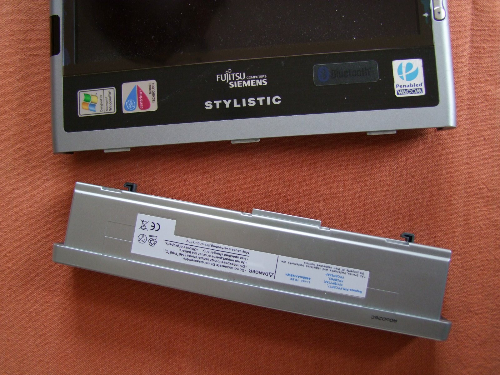

The battery case was good fun to open - glued on all edges. Lots of fairly gentle work with a sharp 1" wood-chisel got it apart without splits.
Looks straightforward enough, and a darn site less convoluted in there than my 24v Bosch drill (at 1.2v apiece!).
Will be interesting to find out the level of charge obtainable.
