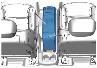

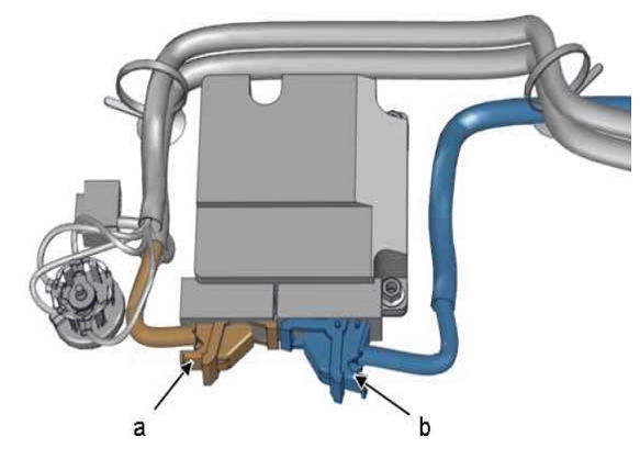

Do you know what the location is of the airbag ecu?
Thanks in advance
x 6963
Re: Airbag light Berlingo 2010
The unit is located inside the central console. Caution though - always disconnect the negative battery terminal and don't allow it to reconnect. Wait 5 minutes or 10 minutes if there is an airbag anomaly before undertaking any work on the airbag control module or systems and never remove the airbag ECU module with the connectors still connected (risk of triggering).
Airbag ECU ModuleCentral Console
