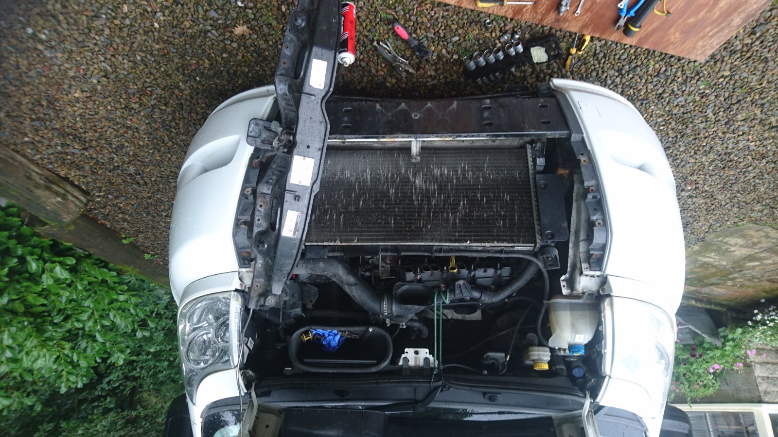

I then removed the slam panel which has 6 x 10mm (hexagon head) bolts, there are 2 x star headed (Philips) screws that keep the air intake tube fastened to the panel to be removed on the back side also.

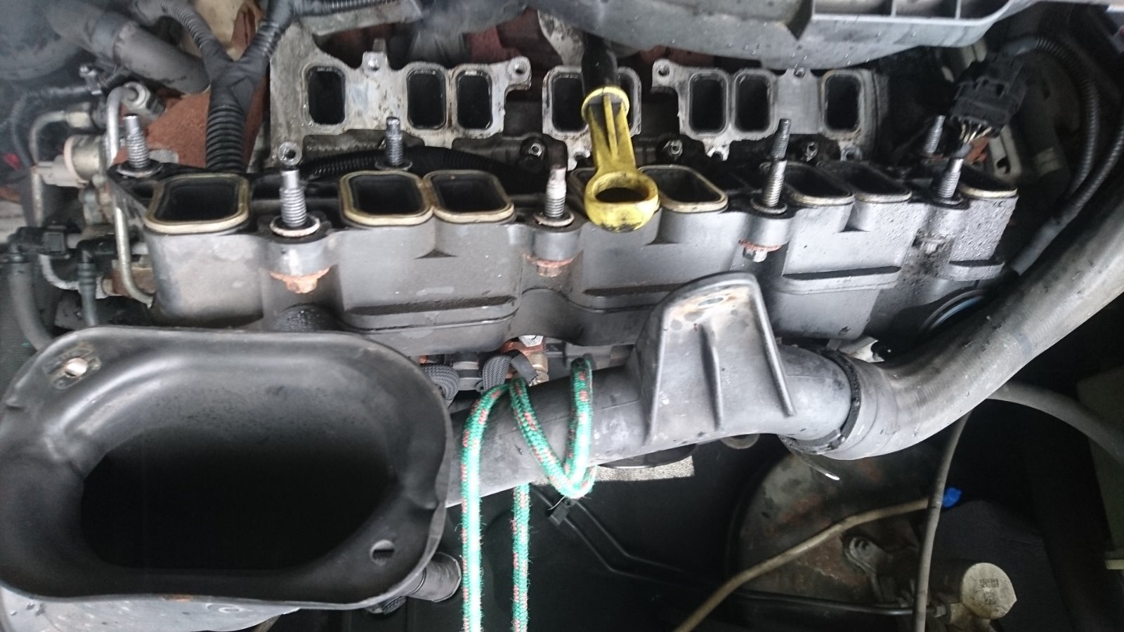

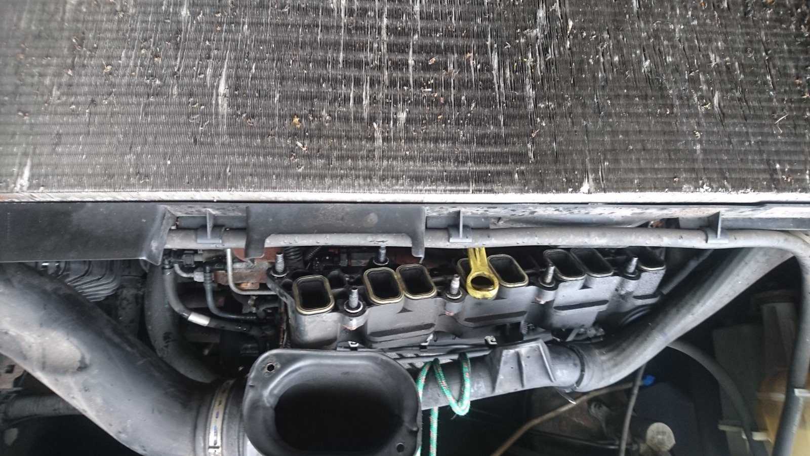

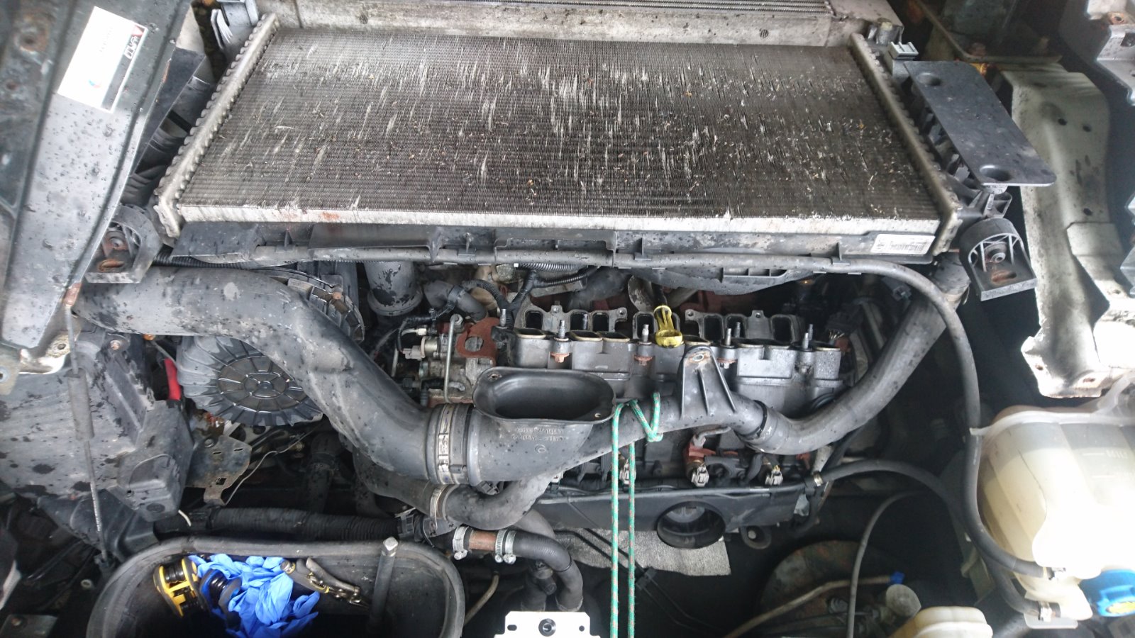

It's a bit of a faff on but it's not a hard job that can be taken on by most home mechanics (with the right tools) in about 4 hours. I held the water pipe out of the way with a bungee. There's no need to remove the radiator, you can see there is plenty of room to work if you look at the images attached. There are NO gaskets to replace the manifold has rubber seals, mine were in good condition.

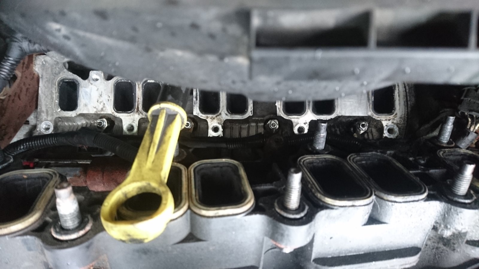

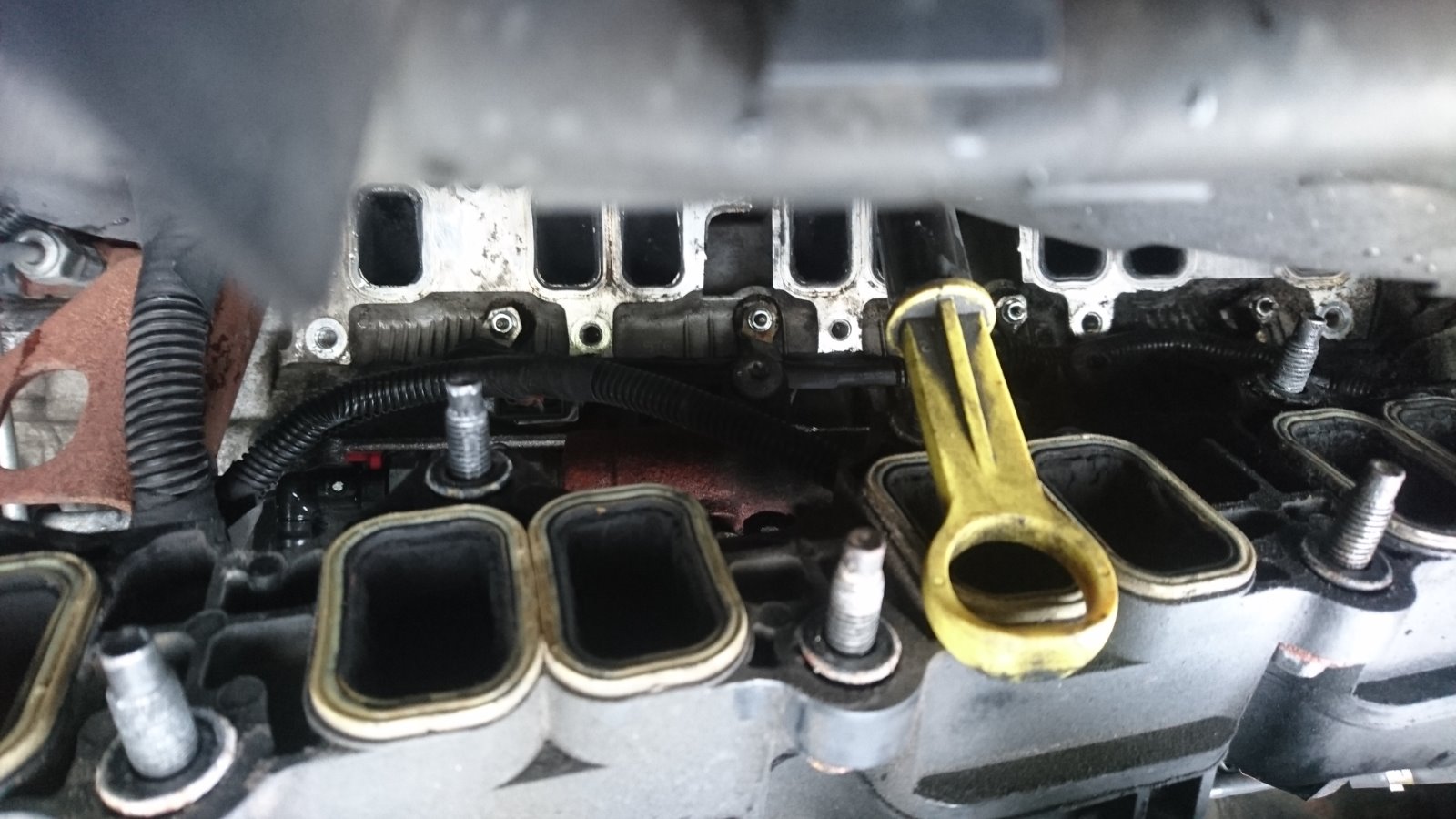

Looking at the images - the top set of holes is the inlet manifold lifted out of the way. The bottom set of holes are the manifolds corresponding holes in the cylinder head (these fit together when bolted up). The dipstick is yellow. Between the 2 sets of holes and near the bottom of the yellow on the dipstick are the 4 x glow plugs across the engine, (small bright silver nuts - these were the new ones in situ).

Radiator still in situ

Better picture of the 4 glow plugs

Top view of everything

View of what needs to be removed to get at everything
