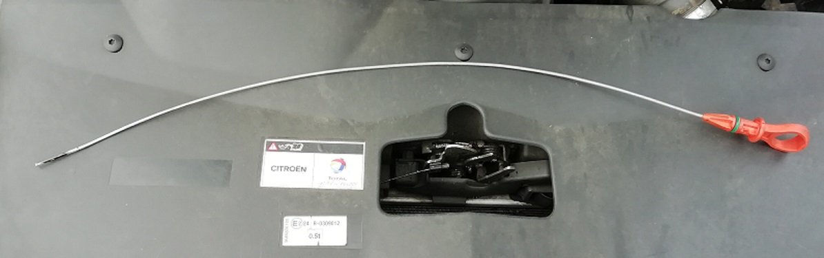

Re: Broken dipstick
I have a C5 Tourer reg in March 2013 and this is the second broken dipstick I have suffered, After the first I was always careful about being smooth and slow when checking the oil. Just had it to a private Citroen mechanic for a service and suffered my second shortened dipstick. Need to have words.

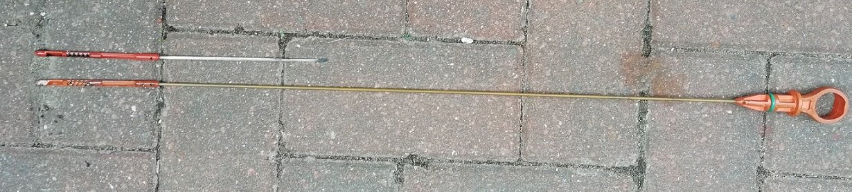

After I received the tool I noticed that the bottom was broken from the orange floor.
it stands like a chronic problem.I bought new and the room was broken, so the big piece was broken.why have they done something solid

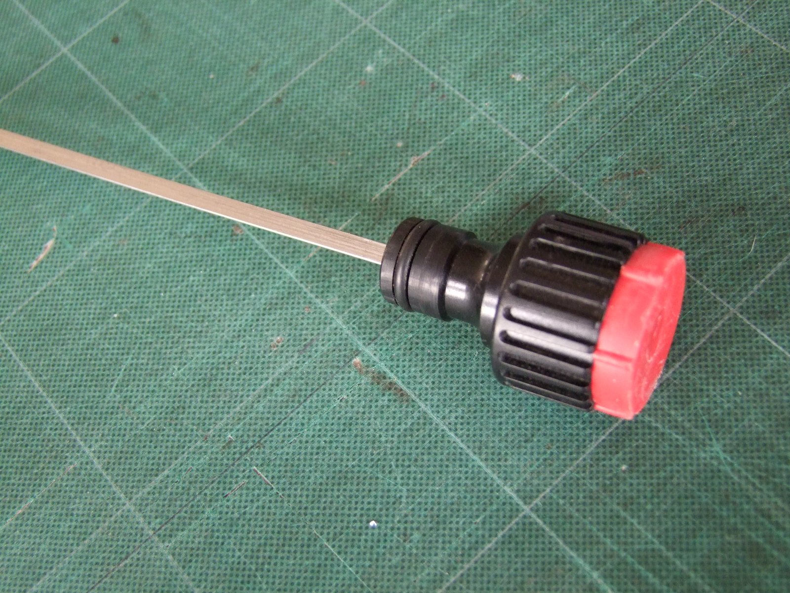

- x 1746
Re: Broken dipstick
A d.i.y. replacement for a crumbled dipstick handle, courtesy of a standard Hozelock fitment and blanking cap.

Re: Broken dipstick
I like that (wasn't even aware that there WAS as blanking cap for such fittings - nor have I seen black ones) & will bear it in mind if my repairs to the Xantia's have not been successful.
What irritates me though is that dipsticks used to have handles formed by bending them in a loop & that design proved entirely satisfactory for 50-odd years, then somebody had a "better" idea, for something that couldn't actually be improved on &, inevitably, came up with something more complicated & expensive - that doesn't work!

- x 1746
Re: Broken dipstick
The ½" blanking cap was just a general plumbing 'throwaway' item - the sort of thing that you find in new plumbing fittings to stop stuff falling in. I have a bag of several of them.
