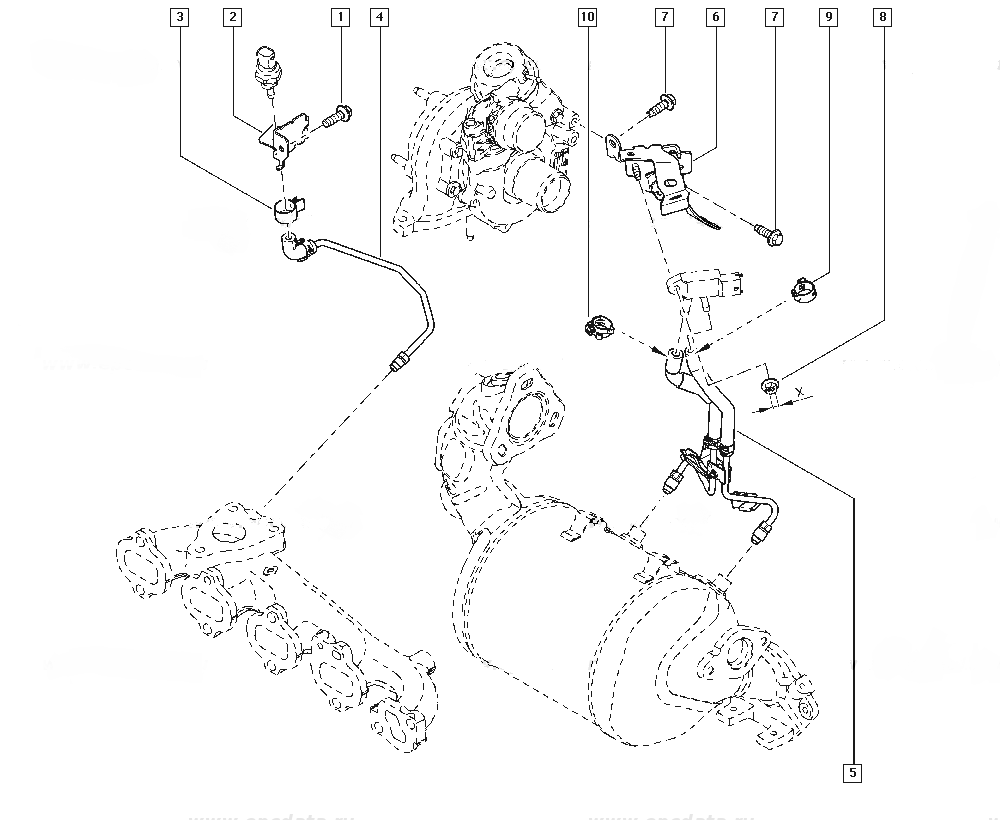

Thanks for the reply. Its the rubber elbow at the top of the pipe labelled 4 on this pic:

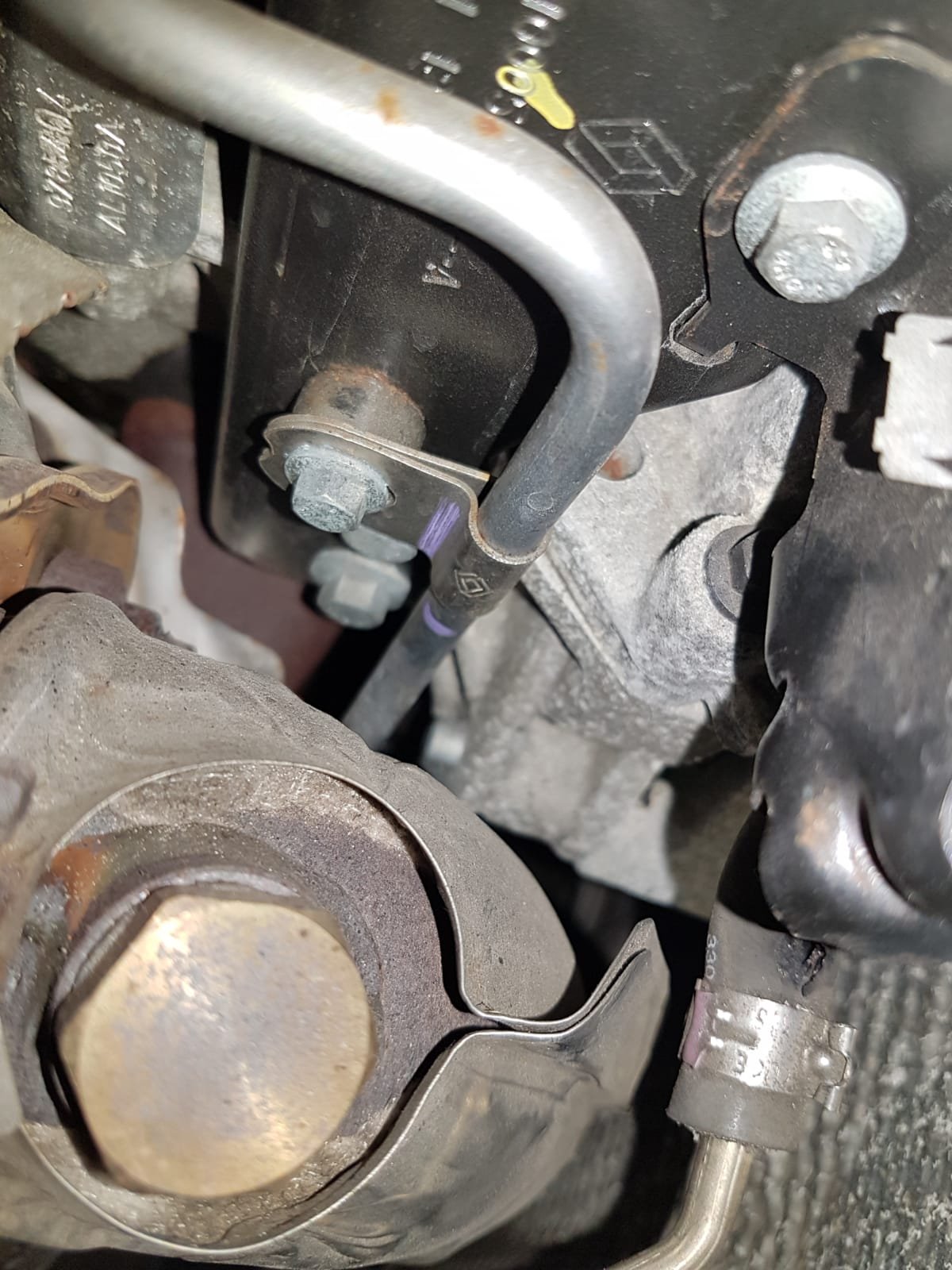

Here is a photo of the split, bottom right. Hard to get to as its at the back of the engine.
I was thinking of just getting some new pipe but its an elbow and takes the heat from the exhaust so not sure it I could get something to do the job.
Did read while searching that someone put a straight pipe on it and modified the bracket but not sure how easy that would be.

It's quite a distance away from the exhaust manifold (the metal pipe run), and the pressure sensor won't be being subjected to huge heat, I guess. The metal pipe will be dissipating most of the heat.
Try a motor factor for a piece of elbowed 'rubber' pipe of suitable diameter; they're bound to have something you can cut a small section from.

Silicone hoses tend not to like very hot conditions; fine for air ducting and coolant, but not at their best on/near hot-spots. Conventional reinforced 'rubber' will fare better, if you can't find any dedicated high-temp hose. Pirtek a good idea; you might even get something externally braided.

Just an update, I purchased some high spec fuel line 8mm and it appear to be holding. Could not get the metal pipe off from the manifold as the access was too tight but attached the fuel line to the top with jubilee clips. Think the 8mm was a bit too big as had to tighten the clips up a lot to get a seal, but I think the next size down (6mm) would be too small.
