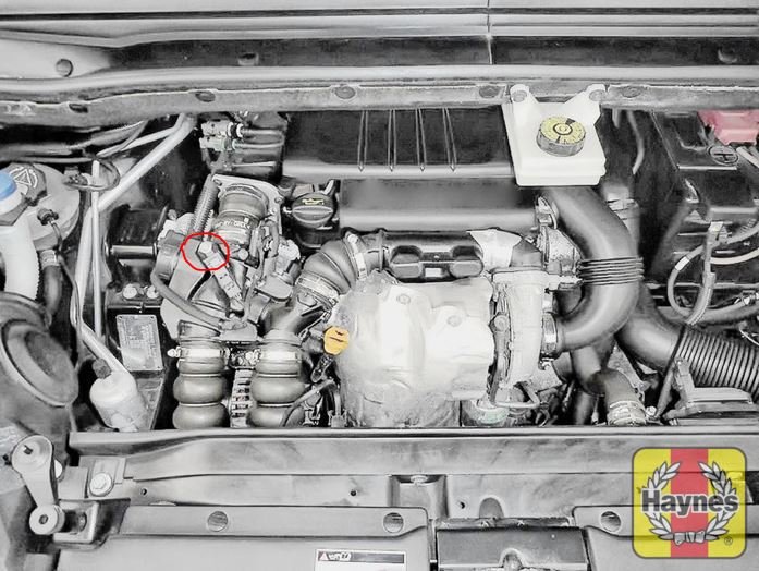

With it being erroneous diagnostics, you might be chasing your tail but the second fault points to the air intake temperature sensor downstream of the turbo.
Courtesy of Haynes, I borrowed this pic... IAT fastening bolt circled in red (it's 8mm).
It would be much more desirable to get it scanned with Diagbox if possible.
