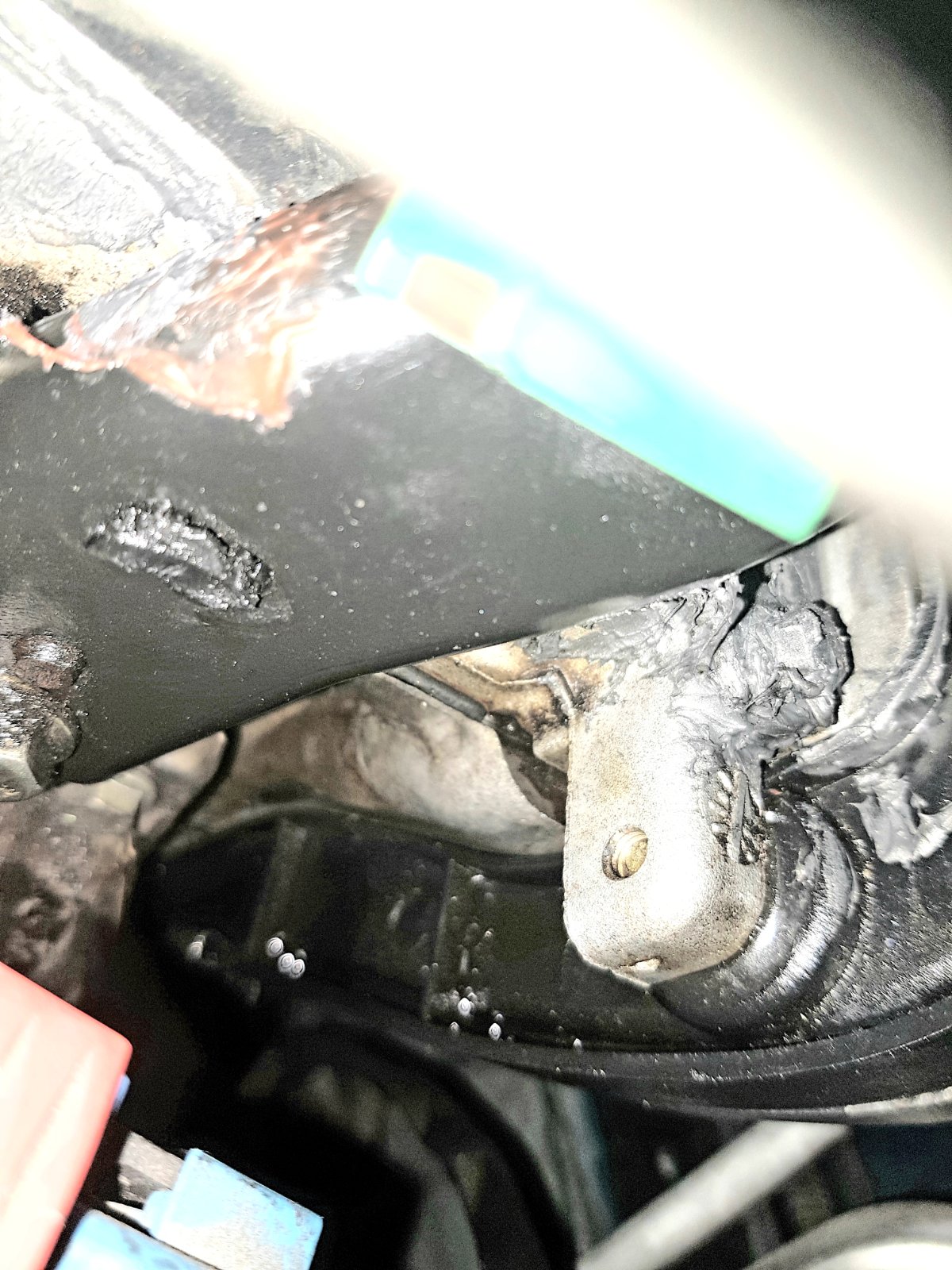

I checked the rear of the engine and here is the location of oil leak. If it is cam seal then the timing belt would already started sleeping, but it is running fine.

Re: Oil leak C5 v6
I don't think that the oil is likely to have caused any damage yet. I think that the leak is most likely from the end of the cam cover, up against the timing belt cover. If the leak was inside the timing belt cover, I think that oil would only be coming out the bottom.

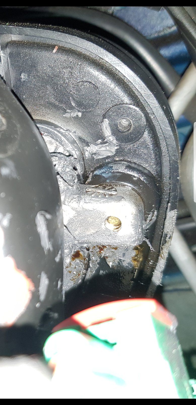

Re: Oil leak C5 v6
i remove few bolts from both covers just to see if there is any oil on timing belt. But it is clean.
Could it be high oil pressure causing cam seal to leak as there is no way to release pressure from leaking rocker cover.

Re: Oil leak C5 v6
zeeshanzaki wrote: 08 Sep 2018, 11:01 i remove few bolts from both covers just to see if there is any oil on timing belt. But it is clean.
The seal on the camshaft is not subject to high pressure oil, only the pressure of the fumes in the crankcase. I have never heard of one leaking.
It is more likely that the cam cover is not sealed properly, particularly on the lower edge where there is a pool of oil on the inside.
Another possibility is that the aluminium block that the cam sits on is not sealed properly to the head, but any leakage there is normally minor, and you need to remove the cams to fix it anyway.

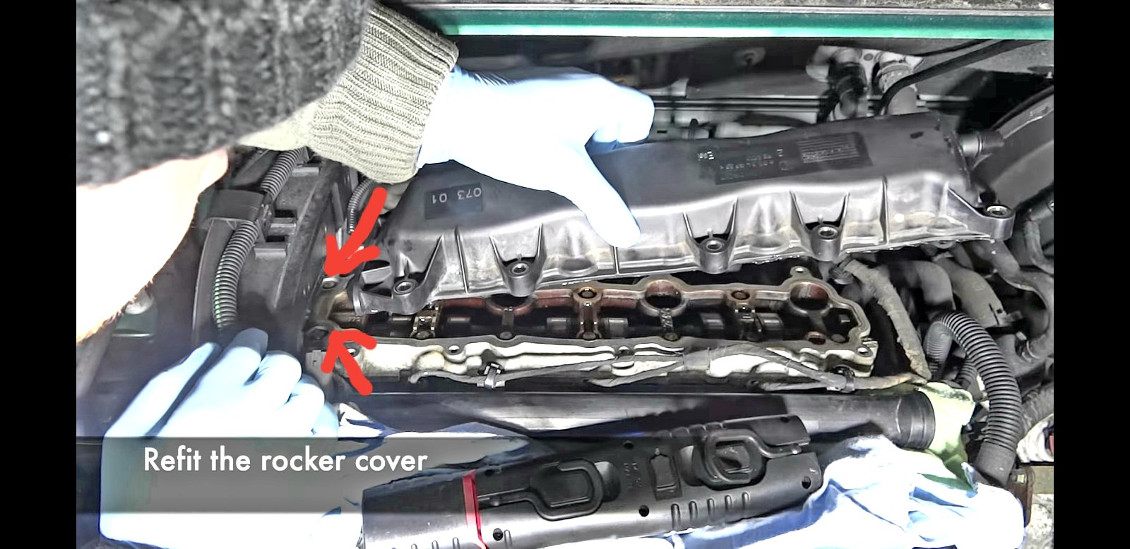

I redo the 4th metal cover so it should not be leaking from the side. Only suspect is the plastic cover might be leaking from the timing cover side. I found that the platic cover has gasket around two holes as shown in the photo (not of my car). Could this hole lead behind timing cover and if it is leaking from there then oil can pass behind the cover.

Re: Oil leak C5 v6
Those 'holes' are recesses for the bolts holding the camshaft bearing cap, so they do not lead directly anywhere.
It sometimes happens that the whole aluminium piece that sits over the camshaft is not properly sealed to the cylinder head, and leaking there, but I have only seen that once and the leak was slight.

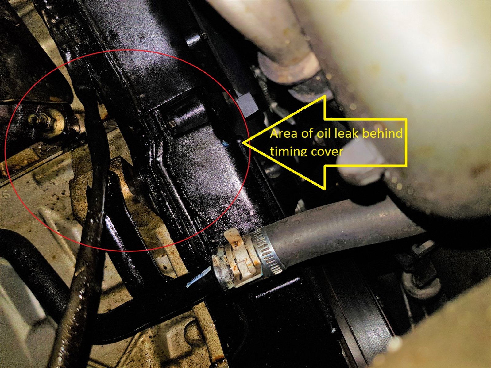

Re: Oil leak C5 v6
Found the source of leak but not sure if its coming from rocker cover or cam seal which behind timing cover bracket. Leak incrased only after doing rocker cover seal.
