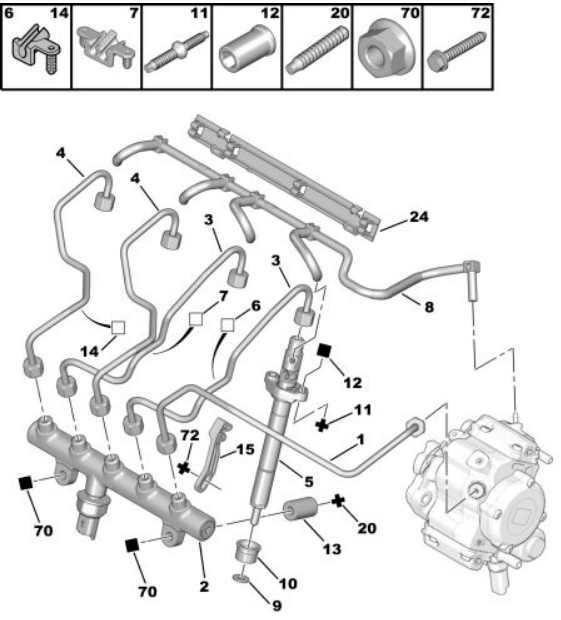

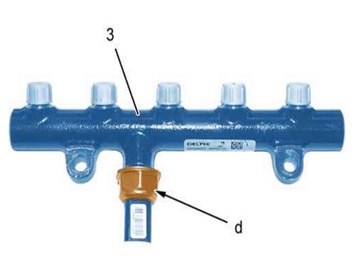

Ok, so I've had a check on this and in the technical section, Citroen actually state
The price form Citroen for the rail is £253.39 inc. VAT. You may be able to source one elsewhere for less, but I'm wondering if separating the sensor is causing the issues you've had?
As you can see from the official parts section below, the actual sensor is not shown as a separate part available.Do not separate the fuel high pressure common injection rail (3) from the fuel high pressure sensor "d".
| Only the Rail itself is shown (Part No: 1570L9) and will likely incorporate the sensor within it. | Citroen stipulate not to separate the sensor |
