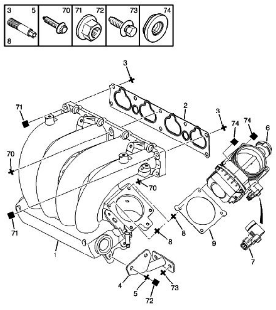

Where on the throttle body is a throttle position sensor? Would like to clean that too.
x 6957
Re: C4 VTS P1644
The actual throttle position sensor is incorporated into the accelerator pedal. The request to open the air regulating flap is no longer a direct command by cable linked to the accelerator pedal.
  • The accelerator pedal sensor informs the injection ECU of the driver’s request.
  • The injection ECU then commands the butterfly housing motor.
  • A potentiometer incorporated in the throttle housing allows the injection computer to determine the exact position of the air regulating flap.
Item 6 is the Air Intake Throttle Valve Housing
If the power fails to the unit, there is a spring incorporated into the unit that allows sufficient air for low power. I don't think you have this fault though or you would be in 'limp home mode'.
It is also odd that your cruise control is working ok - I would expect that it the accelerator pedal sensor was at fault that this would also affect the cruise function. So I'm wondering looking at that Diagbox fault - that it could be a dirty contact as 'Fake Concern' said - on the roller switch of the cruise / limiter stalk. Get some electrical contact in there and work it through whilst spraying.
