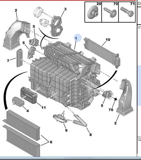

It appears to be on the other side - this view is from the engine side of the heater box

Thanks Richard. I will certainly be having a look on the other side- but I think, at the moment, that the route is via the drivers left foot rest.
Are you thinking that item 8 is the outlet pipe- and that item 9 is fitted remotely?

Yes, 8 and 9 - these are the descriptions:
08 WATER PIPE
09 WATER EVACUATION BOX
To be fair, I always thought ours drained somewhere under the driver's feet, so perhaps the tube goes behind the heater box, and then the drain is under the foot rest.
08 WATER PIPE
