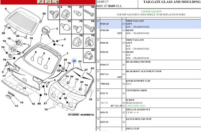

Ok, so my understanding is that the glass itself is bonded to the body like the front windscreen. Is it possible you are referring to the trim that then goes on top of this, see diagram below, part 22 (depending on trim colour).

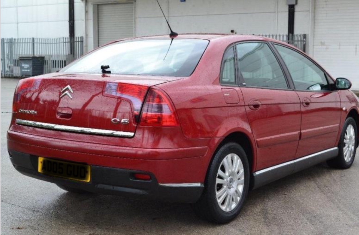

Actually, just looking at a photo, there isn’t anything on top of the outer rear window glass, , so those trim parts must be the internal ones of the tailgate - you can just see them through the rear window in this picture - the large side plastic trim. So apart from the weatherseal which is the flexible rubber tubing that goes on and round the lip of the lower and side parts of the boot, I can’t see what else it could be Bob:

I've got that diagram too but I can't seem to identify the actual part required. The weather strip in question appears to be bonded to the tailgate glass and forms a secondary seal between the glass of the tailgate and the body. I really need to look again in the daylight as I am working from memory at the moment.
Just seen the photo. That's my car!!! Correct colour and everything. Someone has nicked the rear wiper already.
Looking at the photo, between the edge of the rear screen and the body along the top and down the sides there is a gap. This gap is sealed with a weather strip that is glued to the window. That is the seal I am talking about.

No problem Bob, I just pick d that photo up from Gumtree!
However, I’m almost certain that you can’t do anything about the glass as it is literally bonded in place, short of having it replaced. The only thing I have on this is the same as a windscreen fitting company would do, use a wire to cut through the bonding, after the internal trim has been removed. It would have to be all cleaned out and the new bonding sealant applied.
