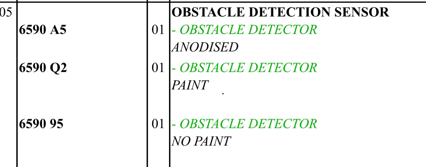

The thing is that according to service.citroen.com using my VIN it clearly gives the specific part no: 6590 95.
That is the reason I ordered a sensor that should be equivalent with this number.
But that number is not in reference to my car in most of the ebay sales so something is wrong here...
My old sensor has the connector at rear but even though if I Google this number (687920A) I will find pictures of sensors with exactly the same number - but with the connector on top?? What? None of the ones in your link are right.
Taking a closer look at the old ones will show three(!) different numbers:
687920A on the top part, the one that is coloured. That number is printed or more likely: melted into the plastic.
602767 on one half of the upper part. The black half. That is also printed/melted.
687855 on the part that is the other half, beige, where the connector is located. That is more of a solid number that is molded into the plastic.
Which one is right??
Sure I will test them "by the finger" but I guess that none of them are operational. System is down, more or less. Until correct sensors are used.

Re: New parking sensors not working - have I forgotten something?
The reason there are 3 types is the anodised one, the painted one and the non painted one, which is 659095 and the one I referenced. Just pick the one you need.
However, the point I am trying to make is that the ones you have linked to are not genuine ones, they are just aftermarket ones and are saying they are compatible with the OEM part number.
The original Citroen / Peugeot one’s are £117 each! The aftermarket ones will be of varying quality so expect to have issues.
