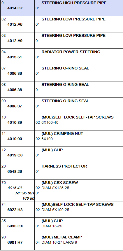

I'm assuming this is the same C5 MK II with VIN ending in 473? In a nutshell - it really depends where the leak is. As you have probably determined from many of us here with X7s, some of us are on our third steering rack due to rusted pinion shaft and the deterioration of the Low / High pressure 'O' ring seals that we can't get from Citroen. The good news it that Citroen do supply the seals on the Mark II steering rack for the pipes, shown as items 7 & 8 on the Power Steering Pipes Parts Table
What you really need to determine is the cause. Has your pinion rusted like most of ours? If it has, then there is no point in paying the labour to take all this lot off and replace the seals if the pinion shaft has rusted into the seal - as the rust will have deformed the sealing area and contaminated the interior of the rack and the seals in there too - if this is the problem.

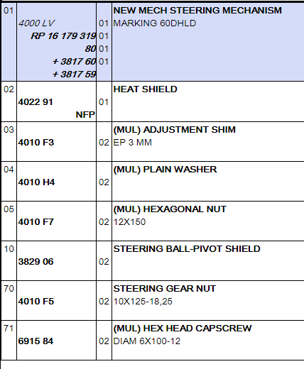

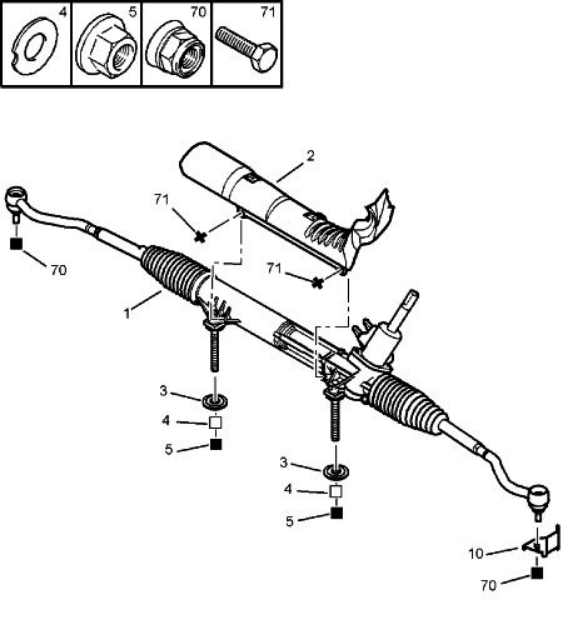

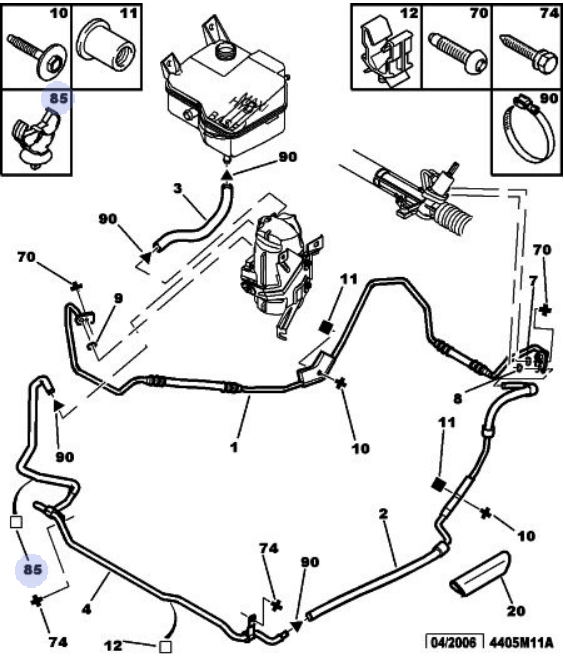

Here is the diagram and part numbers of the rack for your C5:
Click to Zoom the Images
Here's a rusted one: Have a look at the other pictures here on the X7 Steering Rack thread:
viewtopic.php?f=3&t=60155&hilit=pinion+ ... 65#p577764
Power Steering Rack | Steering Rack Parts Table |
Power Steering Piping | Power Steering Pipes Parts Table |

Thanks Marc, I dont know what has happened to be honest. It looks like the leak comes from where the box control valve is. Do you have closer diagram of that?

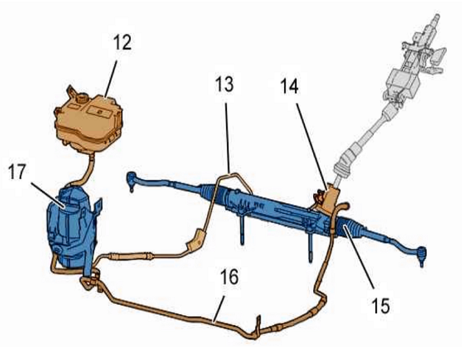

Its where the power steering pump delivers a constant flow rate to the steering rack or box control valve. A friend of mine who have experience disassembling steering rack from his car. He looked under the car.

Ok, so on your C5 with the EW10A Engine, you have the Electro Pump Assembly, so not mechanically driven. See below:
(12)LDS fluid reservoir. (13)High pressure piping. (14)Distribution valve. (15)Steering mechanism. (16)Low pressure piping. (17)Power steering electropump assembly. The flow provided by the power steering electro-pump varies as a function of the following parameters:
Regulation pressure: 100 to 5 bars. |

That was a good illustration of where the electro pump and pipes are located. But Marc, are the 2 first illustrations specific to my cars VIN number as well?
- Posts: 42019
- x 6918
Re: Steering rack diagram - Citroen C5
Yes, the diagrams are from your VIN specifically.

There's a steering oil leak issue and upon diagnosis, my mechanic says that we need to change the 'Radiator Power Steering' (Part 4 - 401351) based on the part diagram and table you have provided above.
The problem is, I'm not able to get hold of a replacement. Upon checking with the local Peugeot, they told me that they don't have it. Any chance you could help find where I can get one.
