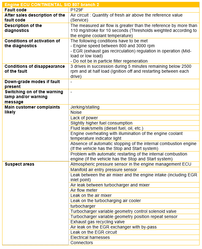

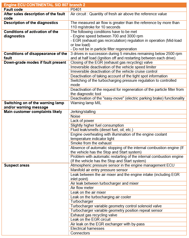

Ok, so here's what I have for these 2 codes - they look very similar, but do have some differences between them.
The fault says there is too much outside air going into the engine. So I would double check your Air Doser unit to see if this is stuck and allowing too much air in. The electrovalve may not be operating correctly. These problems could all be related.
So you have a few areas to look at now.
Click to Zoom and focus the Tables
