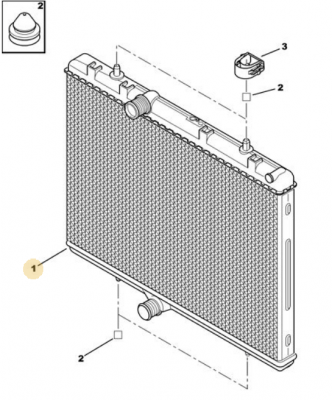

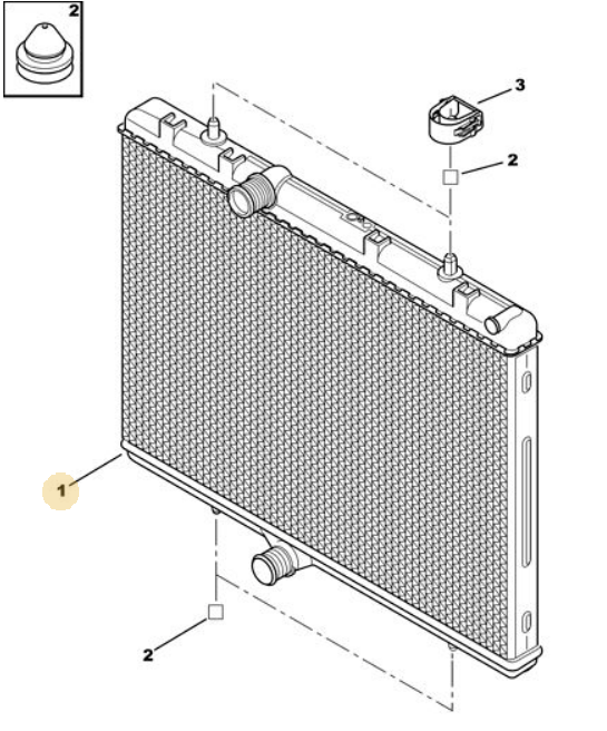

Re: c5 radiator leak
Here you go:
Part 1330T1. £272.84 Brand new from Citroen inc. VAT.
They can be got from here for £79.74 inc. delivery. :-D
