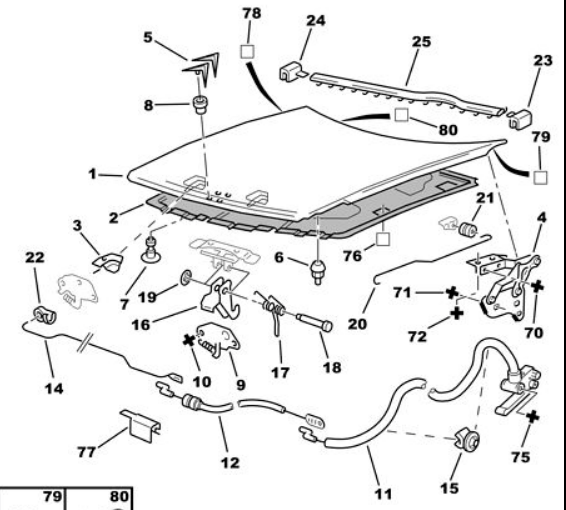

So I'm assuming you can't get it to the first stage release - what about trying to pull the bonnet release wire using a pair of grips; can you get to the wire itself without pulling on the plastic handle. You may then be able to give it a little more welly and free it.

GiveMeABreak wrote: 10 Aug 2018, 15:44 So I'm assuming you can't get it to the first stage release - what about trying to pull the bonnet release wire using a pair of grips; can you get to the wire itself without pulling on the plastic handle. You may then be able to give it a little more welly and free it.
Yep, it doesn't shift onto the safety latch.
I'm not just worried about the pull cord end, I'm also worried about the joint between 12 and 14 giving way :?
