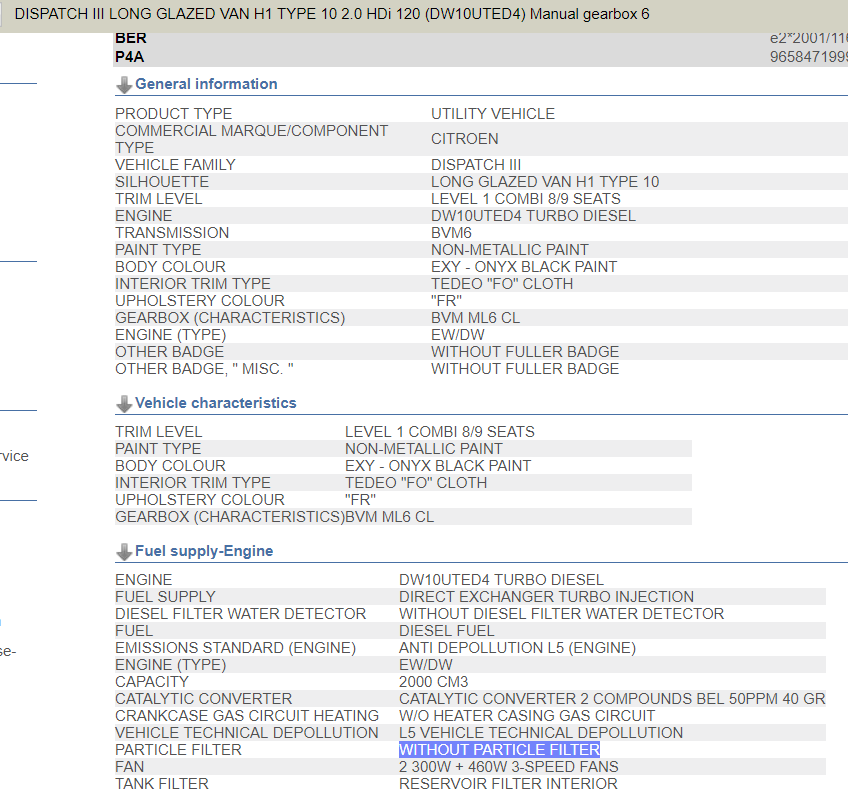

Ok so you have the DISPATCH III LONG GLAZED VAN H1 TYPE 10 2.0 HDi 120 with the DW10UTED4 engine and Manual gearbox 6-Speed gearbox.
There is NO Diesel Particulate Filter on this variant according to your VIN, although some versions do have one. So that eliminates a clogged DPF.

No DPF - confirmed from your VIN (see extract below). The DPF is contained within the exhaust system below the catalytic converter section - it does not have any wiring. You are probably looking at the engine ECU or one of the other electro valves / connectors.
