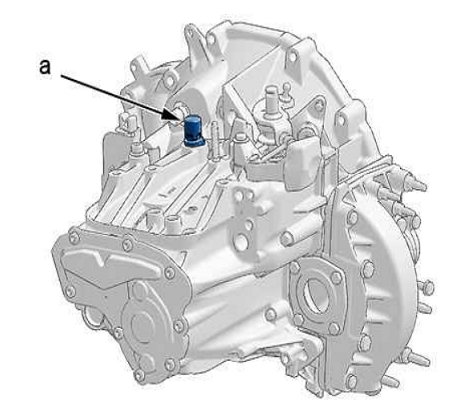

Type of oil for the MLC 6 Speed Box on your C4 (B7) is:
Either ESSO 75W80 EZL 848 or TOTAL 75W80 H6965.
Capacities:
Note you have the 'DW' engine in this table so the values marked in red.
Quantity of oil to fill after draining
Engines:EWDW
Gearbox casing with fins1.7 l1.9 l
Gearbox casing without fins2.4 l2.6 l
The following is only if undertaking a full overhaul, otherwise for draining and refilling use the table above.
Quantity of oil to fill after an overhaul
Engines:EWDW
Gearbox casing with fins2.0 l2.2 l
Gearbox casing without fins2.7 l2.9 l

Remove the under engine protection
Remove the Drain Plug (1) fitted with its seal
Refilling
Refit the Drain Cap with a NEW seal
Fit the cap
Remove the air filter housing if necessary
Refill tthe gearbox via the vent hole (a)

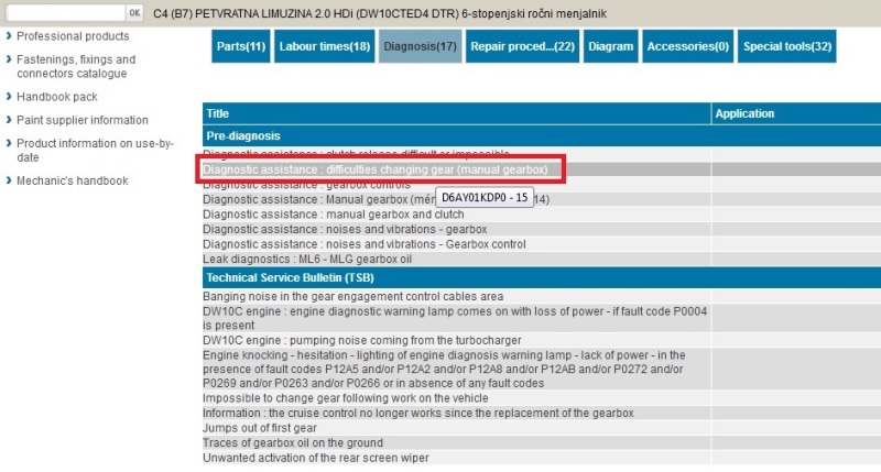

Another thing... I have access to Citroen Service but limited. Does anyone have access to this diagnostic guide and can get me a print screen or send me the file?

Re: 2011 C4 2.0 HDI hard gear change
Check your email :wink:
Unread post by xantos »
Thank you very much! =D>
It wouldn't be to cheeky to ask for the next 3 files on the list would it? :oops:
I have 2 - they're on their way.
