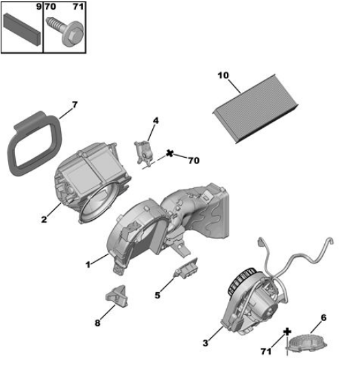

Mike - just to confirm, there is no air conditioning on Rich's Dispatch.
I suspect the air mixing motor (s) gear has stopped working or snapped - leaving it in the same position. So when the engine is cold the air is cold, but when warmed up, it is just allowing the warmed air through - and changing the air mixing controls is making no difference - I will have a look at the details shortly and post up what I have.
- x 6945
Re: Dispatch blowers
| Part No 4 (647971) £55.85 from Citroen Inc. VAT This is the A/C Reduction Gear (still called the same even though you don't have A/C! |
