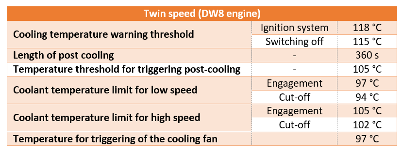

Ok, so you have the DW8 engine and this table explains the temperature values. You don't have Air Conditioning on this model, so only a 2 speed fan.

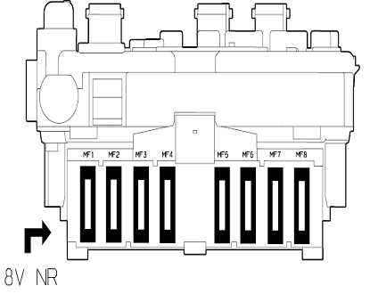

Check out Fuse F4 (10A) & F8 (20 Amp) in the engine compartment Fuse Box: And the Relays:
MF1 is the 20A - 80 Amp Cooling Fan Relay

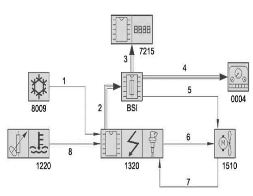

This is the control diagram. The additional power you are detecting will be from the Fan Resistance unit (not show below).
(*) For vehicles with a three-speed cooling fan (fitted to vehicles with air conditioning), mid speed is controlled by the BSI. The low and high speed controls remain unchanged.
Components BSI: Built-in systems interface 0004: Instrument panel 1220: engine coolant temperature sensor 1320: Engine ECU 1510: electric cooling fan unit 7215: multifunction screen 8009: Linear pressure sensor |
| Connections | Single arrow: Wire connection Triple arrow: Multiplexed connection | |
| No. of link | Signal | Nature of Signal |
| 1 | Air conditioning circuit pressure | Analogue |
| 2 | Engine coolant temperature information. Information on the engine coolant temperature alert | CAN |
| 3 | Issuing of the message: Engine water temperature warning | Comfort VAN |
| 4 | Engine coolant temperature information. Information on the engine coolant temperature alert | Comfort VAN |
| 5 | Control of the fan assembly (at mid speed only) (*) | All or nothing |
| 6 | Control of the fan assembly (normal or fast speed) | All or nothing |
| 7 | Cooling fan rotation information | All or nothing |
| 8 | Engine coolant temperature information | Analogue |

It should be about 105 as per the table. Maybe replacing the temp sensor will rule that our for sure? - they're quite cheap to replace.
