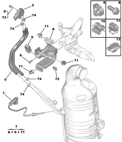

Here are the diagrams I have - just for identification:
Part 17 is the Particle Filter Pressure Pipe (In)
Part 18 is the Particle Filter Pressure Pipe (Out)
Here is the Exhaust Gas Temperature Sensor:
1 is the Gas Temperature Sensor
5 is the DPF Differential Pressure Pipe
So the EGT sensor would have to go inside there to do its job, like a probe.

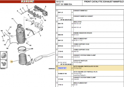

I've not used them personally - but I forgot the part numbers: Either of the 2 part numbers shown at (12):
9677468180
1606857180
Click to Zoom
