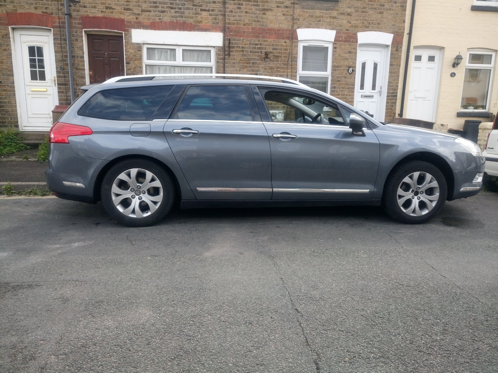

I've attached photo of my x7 estate (hopefully) and it looks like rear of car is sitting lower than front. Is this normal? Car is unladen and cycles through raising and lowering ok.

Either the back has dropped or the front is too high. I have had both happen to mine in the last year.
I corrected the front being too high by using lexia but had to manually adjust the height sensor for the rear, as it was driving with the back end fully in the air

It does look a little low at the rear to me from the picture. Make sure it is supported independently first, then have a look under the rear and see if the height corrector is caked in rust. That whole area is a rust magnet including the rear accumulator spheres.

Thanks guys and I've had a quick look at the back end, no rust or anything obviously wrong with the rear ride height sensors/linkages. I cycled the car through the full up and down a few times and noticed that when I return it to the normal driving setting the rear dips down at the last minute to compensate. I therefore think the front is a tad too high so I'll put car on lexia and see what I can find.

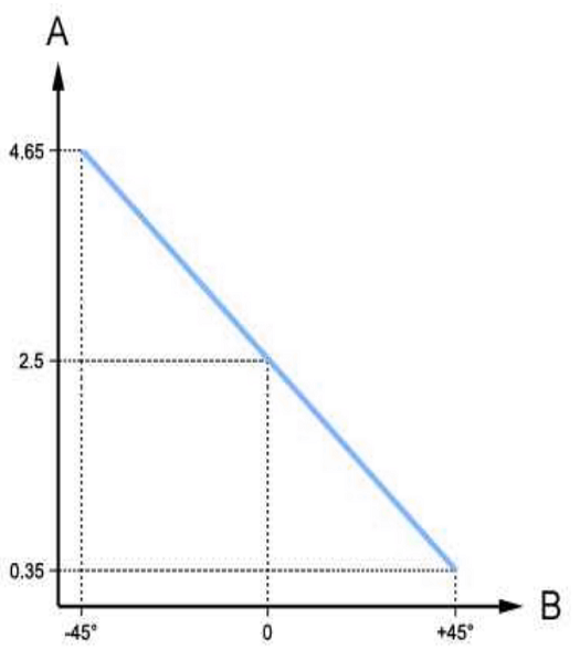

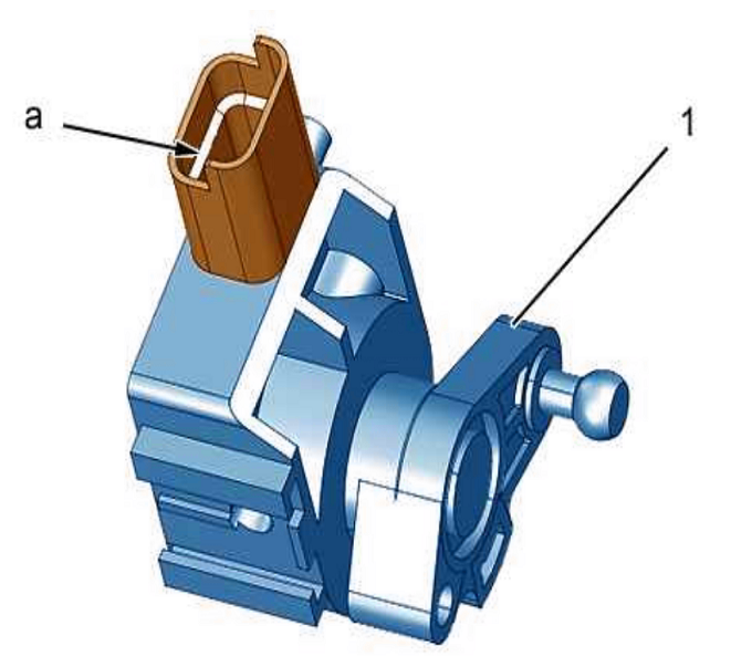

I still suspect the rear height corrector - they are prone to water ingress and can affect the signal / voltage sent, but also can simply wear out - this should help explain it:
There is a 3 way connector. It is a 5V supply and is an analogue signal.
So you can see that at 'normal' height at rest it should be sending 2.5 V, but if it is sending a slightly higher voltage, the suspension ECU will likely think the car is too low and raise it a little to compensate. So it may be at a particular part of the track - at rest (where it is most of the time) that is getting worn or has some corrosion.
Graph (4 Cylinder X7 Only)
| Height Corrector (4 Cylinder X7 Only) Water ingress at the connector or at the rotational joints can gradually cause issues. |
| Channel | Matching Track |
| 1 | Sensor Positive Supply |
| 2 | Body Height Sensor Signal |
| 3 | Sensor Negative Supply |

That is an excellent diagram Marc, very useful. Potentially any additional resistance along the wire (from poor or corroded connectors) could end up affecting the ride height then. Not an ideal situation.
