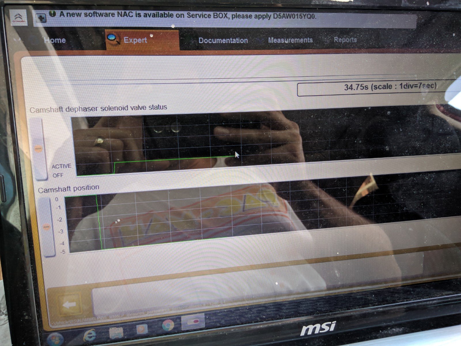

I have a problem with my VVT system. car gives an error p0012. I have changed vvt dephaser, selenoid, crank, crank pulley, camshaft sensor, oil and water pump and timing belt. The car cuts out about 4500 rpm. Gives the anti anti pollution information screen and faulty engine management. Service light Come up.

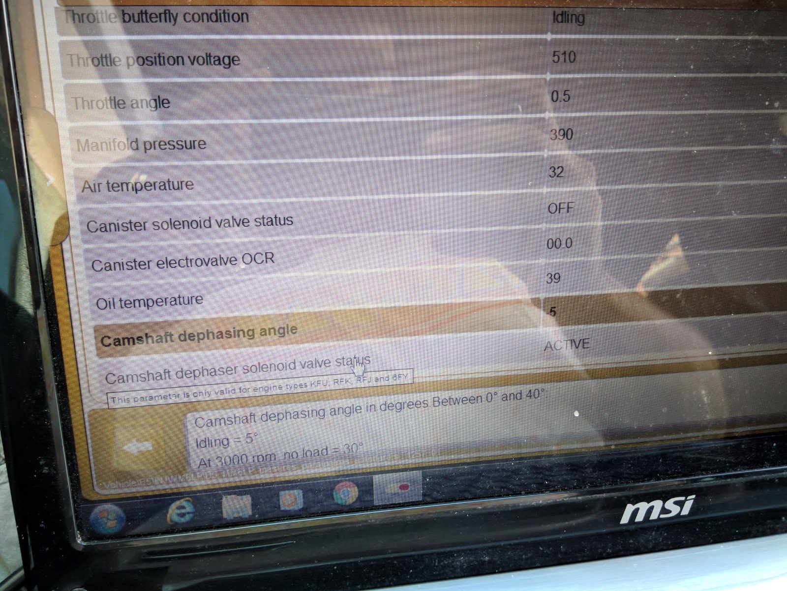

I found in "diagbox" camshaft intake position stuck at -5 degrees, but it must be +5 degrees at 700 rpm idle, no load 3000 rpm +30 degrees. Camshaft sensor read properly and selenoid is working tested (another car same engine).

engine oil and filter changed 300 km ago. filter is oem citroen, oil 5w40 for rfk engine spec.
i dont understand one thing
camshaft position always stuck ? if it is not working how can i find it ?
