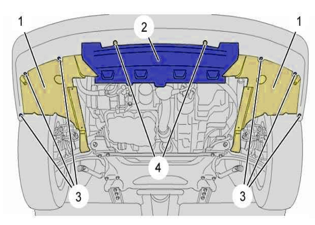

In order to get at the lower bolts, you need to take the bumper off - but I'm not sure whether you may be able to access the bolt with a partial removal on one side or not. So I've included the procedure for bumper removal and refitting in case - I guess you will be able to determine the access to it when you give it a go - so try on the driver side first and see how you go.

Front Bumper Removal
Remove:
  • The screws (3) and (4)
  • The protection deflectors (1) and (2)
Remove the bolts (5) each side.
